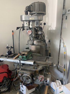

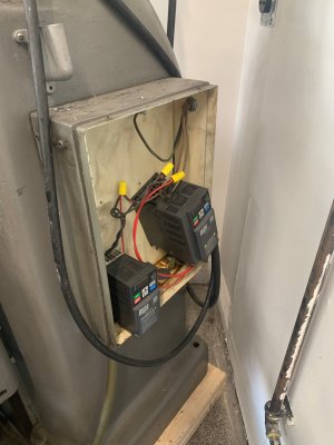

I’m currently in the process of cleaning up a Tree 2URV-C Milling Machine that I found locally. The previous owner “hung” a VFD in the old control box, and wired in both Spindle & Table motors. I’ve since picked up a smaller VFD to match the table motor. Ideally, I’d like to power both VFDs off the same single phase 30a circuit, with some form of on/off (power disconnect) so I can leave it plugged in at the wall. I’m trying to educate myself, but would appreciate if anyone has suggestions on wiring layout, control mounting, and protection/coverage. I could build bases for the power switch & smaller VFD, that would put the faces the same, and I could build a cover to fit the original enclosure. Other ideas?

There's a couple eleck-chickuns on the forum, or at least, very knowledgeable fellows on this.
There's a few things you will need to know before you start pulling wire.
Amp draw of each motor, distance to your breaker panel and so forth.
I know enough about magic smoke to know to respect it with high regard lol
If you're not confident or unsure...seek a professional
Your insurance broker will love you for it
