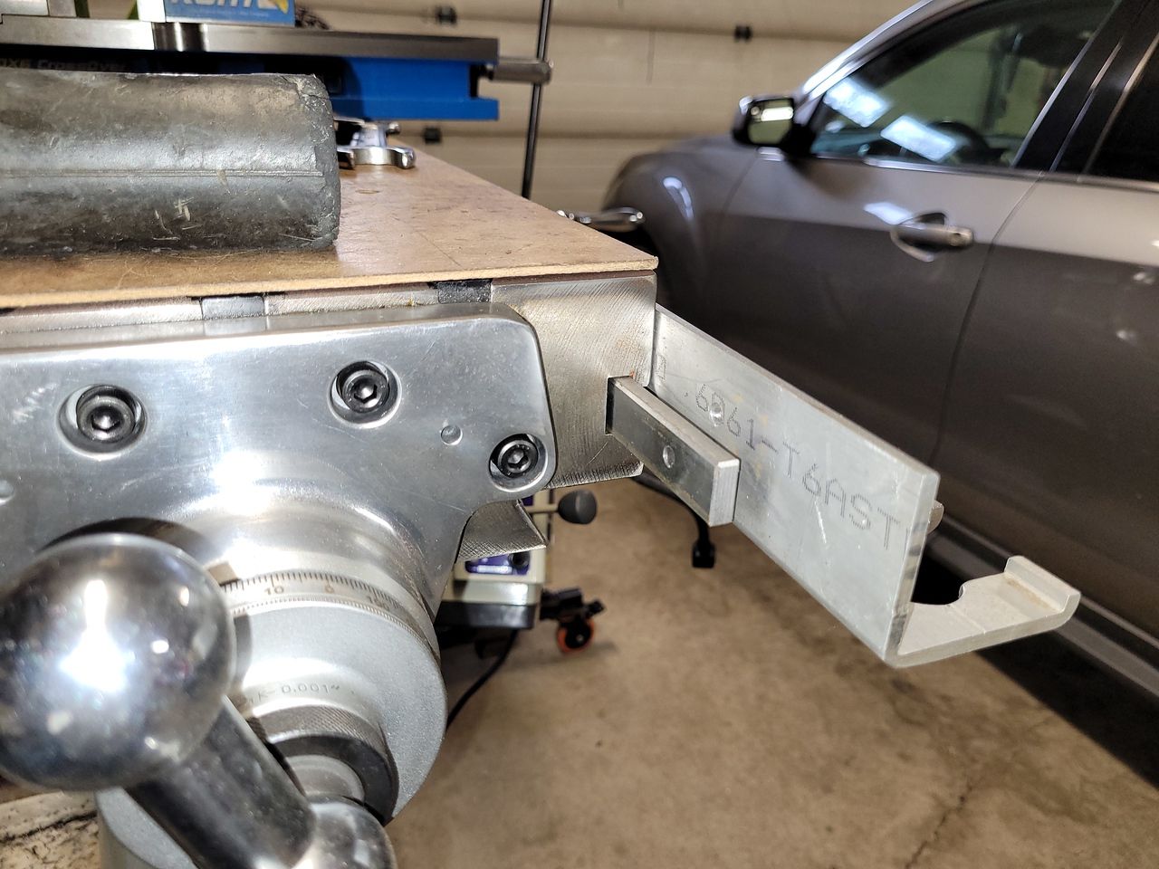

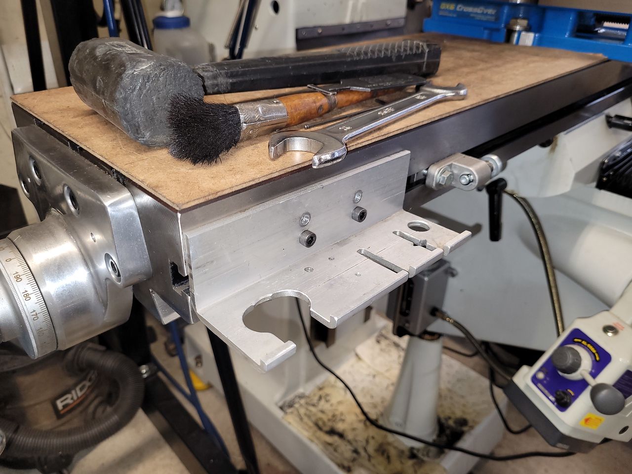

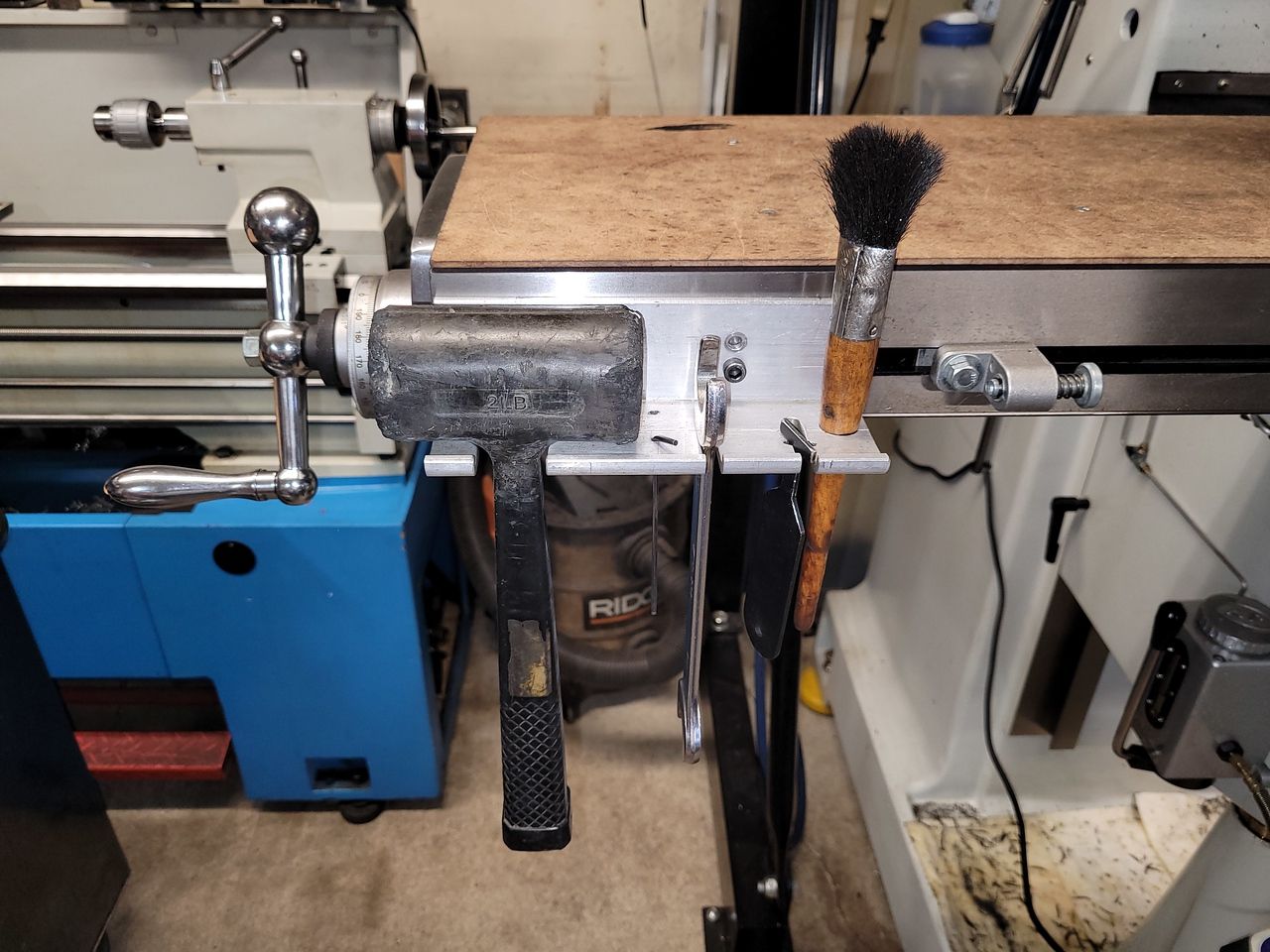

I have a similar one that I originally had on my Ferro mill. I had to relocate the mounting holes to suit the new mill. It holds the small hex key for my vise stop, a dead blow hammer, the wrench for the vise hold down bolts, a t-slot scraper and chip brush. Made from a short length of 2" square aluminum tube. It can be removed in seconds if I need the full travel of the X axis.
