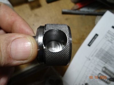

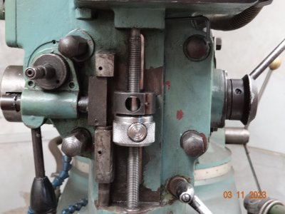

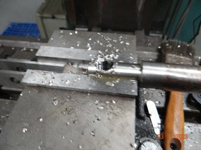

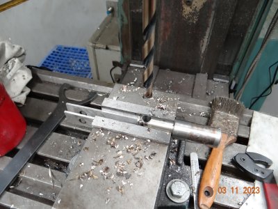

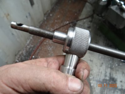

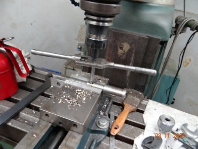

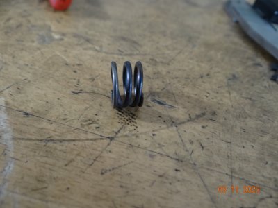

Repeated hole drilling to a set depth means twiddling with the stop collars on the mill for 5 minutes til you get it where you want it, and then doing it all over again when you want full stroke. So I made myself a push button quick lock setup. The thread on the depth stop is 12x1mm, of course I had to order a tap
I started sifting through all the stub ends from projects completed in the past. Needed a short bit of 1.75 CR and a piece of 3/4" stock.
It's hard to believe, but I don't have one. So a stub of 1" had to be turned down.
I found a little bit of 1.75", barely enough to grab in the chuck as there was a bit of whittling to do. I managed to machine away the damages on it, almost...and then knurled it. Flipped it around in the jaws and grabbed the knurled end with some pop can shims to protect the knurl, and bored it to 12mm. Then I could stabilize with the live center, and machine the collar that goes up into the quill block.
Now the fun part. I have to bore a hole into it for the half nut button thing, and make some relief for a spring, all without punching through the other side.
I'm sure there is a proper way to do this, but lacking the know how, I drew it out on the plasma program to scale, and made .100 as my safety margin to breakthrough. I measured the depth on the screen, and then used a 3/4" end mill to drill down the required depth, and it worked. Then I threaded the stock that will be my button, and as in the 3rd picture, I moved over and used a 1/2 endmill to punch out space for the threaded rod when disengaged. It took a little filing and fiddling til I had a smooth transition from thread engaged to disengaged position.
Picture 4 shows a test assembly of the gizmo. In #5, I had to find a spring the right size and cut it and pull some temper so it was not too stiff. The spring fits in the hole shown in #6, then the threaded rod slides in and the spring pushes the half nut into the rod to engage. Push the button in to disengage the halfnut and slide it to where you want it.
It works fine. My explanation may be a bit lacking....

I've had making one of on my to do wish list for a while, nice job!
D :cool:
Well done.
My mill "had" the same 12x1mm rod as yours but rather than order a tap I turned a new rod with 1/2 -20 tread then ordered a cheap clamp style stop.
I searched as well and never found a stop with the metric thread.
The thing with the 1mm thread is each turn of the nut is 1 mm, 1/2 turn...you get the picture. For fine critical depth setting. At first I was going to go your route, but thinking about it, I wanted the fine adjustment ability. The 12x1 tap and accompanying die was 15 bucks free ship from china. As I procrastinated for many years to get this done, a 2 week wait from china was ok.
As far as your ToDo list, this is a simple under 2 hr job with this design. Some others I have seen are more complex, and cannot be rotated to fine adjust the depth. There is no critical measurements, and the hardest part for me was finding the right spring in my spring jar, and fine tuning it.

I've looked at the button type but haven't been willing to pay the price. Now that I see how they're built I think I'll build one as well still with the 1/2-20 as I don't have the metric tooling. With my mill I'll be able to get close to 180 degrees of adjustment which is double what I get with the clamp style.

I happened to be ordering a bunch of parts already from H&W, but I included this one in my order and it works a treat.

Gotta luv inspiration, spent a few hours in the shop over the last couple of days and look what happened.
The button might be a bit long but it makes a good handle. lol
Well, hell, look at that.:)
If you want to shave down the button, you could rotate it for fine adjustment, but you know that.
It's a pretty easy project to make.
YotaBota
Mike
I can get over 180 degrees of travel with the button the way it is and that gives me 0.025 of adjustment which isn't bad, but I think I'll cut it down to have the full 0.050 adjustment.
And you're right, it is a fairly easy project.

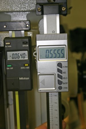

I spent 1/2 an hour this afternoon working out how I wanted to tackle the quill scale for the DRO. I wanted unobtrusive, compact, non-interference fit. I also wanted to have minimal modification of the mill. I've figured out a way that should have great alignment, yet allows for potential misalignment, and that can be accomplished by only tapping two holes.
I've decided to use low profile magnetic tape for the quill rather than the scale we have. That tape will be situated where the current crappy 5" scale is located. But it will be longer, running the full length of the area shown in yellow in the image below. This will allow me space to "park" the read head at the top of the microscrew when the Stop knob is fully at the top of the screw.
Then I'll make a custom mount that will attach the magnetic encoder head directly to the Quill Stop Knob. I plan to use a screw in post that extends thru the mount into the hole in the stop knob to locate and orient the read head in proper alignment with and perpendicular to the magnetic tape. Plus I'll tap the stop knob for two 3mm cap head screws to use to prevent the mount from rotating at all in case there is a little slop due to my poor machining skills.
Do you have a 4-axis DRO display box to capture the reading or what is the plan there?
The quill style really is a no brainer for mounting & still maintaining access to existing mechanical functions. The grey one is the typical Chinese model, has larger display than Mitutoyo.

Here are close-up photos of my quill DRO Scale install. Because the quill Knob is round, only one screw is required to hold the sensor bracket in place. The scale does not interfere with reading the scale or adjusting the stop. As a bonus, the DRO can be used to adjust the stop with precision. I love it.
I am unsure of mounting the sensor itself such that it can read a magnetic strip without hiding a manual ruler scale behind it though.....
Also the flat face length where the ruler mounts is inadequate to accommodate the total length of the magnetic strip that is required. Not good...... Plus the feed clutch is in there too. More not good.
In case you are wondering, the unused threaded hole in the sensor bracket is there to accommodate a post to provide cable relief.
