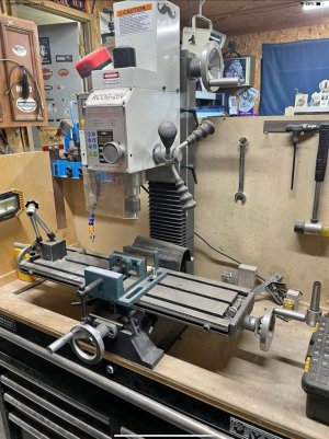

Hey guys.
There is a mill available up in Ottawa for $1200 with accessories.
The written portion of the ad says it’s a Grizzly G0704, but the branding on the machine in the photo says RCOG-25V.
While the two machines may be basically the same, are they really.
Because of space issues, I would like to replace my General International bench top drill press with this.
Any thoughts before I call the guy?
That class are all basically the same with maybe some better quality control on the name brand machines.
The generic type is BF20, and yes it is like the King KC20-VS. (I'm very happy with mine) Except the picture doesn't show a gear change so you might lose some low speed oomph.
Given everything listed in the ad is included, why are you waiting!
