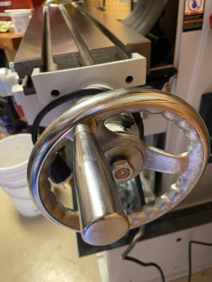

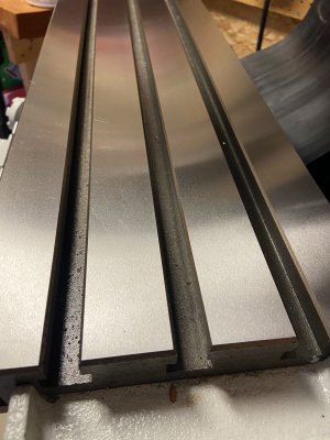

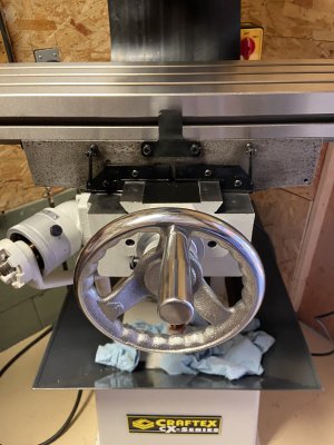

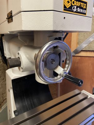

I started my first post on a metal lathe, now that the lathe has settled in I have had to help a friend dig a serious hole to burry a body and WHALA, would't you know it, Busy Bee out of "Berta" sent me a 603 knee mill. The darling showed up in the gravel driveway last week all "jailed" up in her crate, thanks "Just one guy metal works for promoting your "Wendy," it worked. I tore her down a bit to move her and with the help and advice of a few here I rolled her into position over some rough terrain, today was finally assembly and her maiden power up and positioning.
Let's get to the point here, I am very impressed at the quality, I was actually expecting disappointment and much slopiness in the parts, this was NOT to be the case. Granted the ways were not hand scraped and in fact it appears the head mount to the body looks like it was trued with some minor scraping. In the future days of rigging out this machine out I will properly tram it and check the measurements for accuracy, but for now I can not say anything bad about this machine, other that the price, but that's only because I'm in part a cheap Scott, but truth be told a Heintz 57 mutt.

Like I mentioned earlier, so far I'm very happy with the quality, here are a few close ups of the finish.
Any thoughts on my first tooling, R8 collet set and a fly cutter/end mill cutter? I have a nice vice I bought for it months ago, work clamping kit? please fire away.

Btw, nice machine! I'd really like to see the whole thing though.
