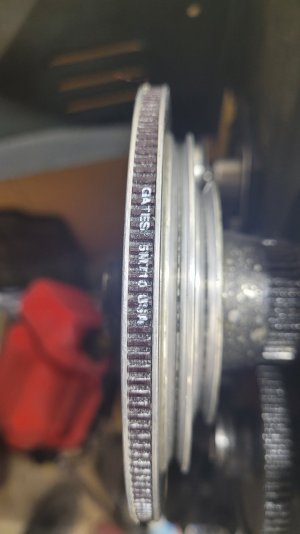

Belts for the lathe and the mill have arrived.
Fit is good on the lathe belt.
Ran it up for a couple minutes and it tracks well.
Proof will be when I put it to work though.
Those Asian copycats even got the font down.
Check out the tag, I'm having a laugh here
Ya that's sort of like my fake Mitutoyo test indicator that I ordered from Aliexpress, it said "Made in Japan ".
The timing belt for my Hartford was custom made in the USA by Gates. It was ordered for me by MSC Direct. Can't say enough good things about the whole deal.
@Dabbler I read years ago about one of those Chinese factory cities.
Named USA...
So since then, I've always been skeptical of Made in USA.
Now, at least Squatch has a legit North American made piece.

That one Gates timing belt from MSC was so cheap I actually felt guilty. I knew there was NO WAY they could do it for that. Basically, they were doing a favour for the lady at MSC who prolly ordered thousands of other belts. So my guess is that they did it for her not me. My guilt made me order 2 belts even though I knew I'd never need them and I also knew there was a risk it wouldn't fit. You could never wipe the smile off my face with a wolly mammoth trunk! Even today, a live skunks tail wouldn't cut it!
If the part #'s jive...the Indumas belt "online" price from MSC, who gets Jason Industrial to make for them, cough cough
was something higher than 400 cdn
I REALLY hope these other belts fit lol.
If not...I guess they'll end up as something else in the shop! ;)
Just an update on the lathe belt from USA...I've done some light and heavy cuts with it now...and it looks to be running fine...
Runs quiet...hasn't skipped off under load...the compound of rubber isn't disintegrating so far...
I think for the 40$ investment it is a win...
