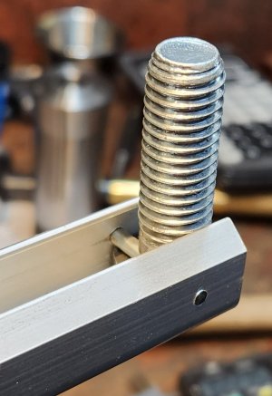

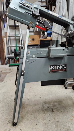

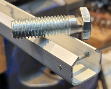

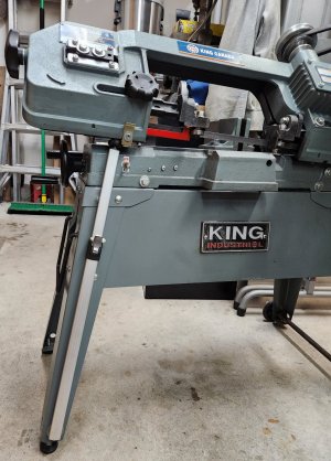

I got frustrated the other day trying to position a small piece on the saw, at an angle, with a jacking screw on one end of saw jaws, while trying to position the blade where I wanted the cut. Using both hands, and holding the upper saw cradled in my lap. What a PITA.
So today a quick job. Using a broken camera tripod that I had lying around for years, (you never know, I you could use that! I'm not a hoarder, but....!!)
Using one of the legs, bolted it to the saw base, and now I can raise the saw and keep it in any position by locking it in place until I'm ready to cut, then unlock it and the leg segment can be lowered out of the way.

Thats one of the small saws and the only assist they have is the counter balance spring, it isn't until you get a 7x12 that you have hydraulic cut control as the head is significantly heavier.
Nice idea for the prop. for the increased production rate.
