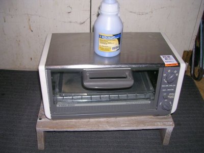

What parts? Powder from PA and a toaster oven from the thrift store, that's it. Maybe some parchment paper. I picked up a toaster oven for $10 at our local thrift store.
Powder coating is the route my son and i are going to go for 9mm and 45 cast bullets. BIL says that is the way to go, he loads for several rifle calibers with cast bullets, no more mucking about with lube.

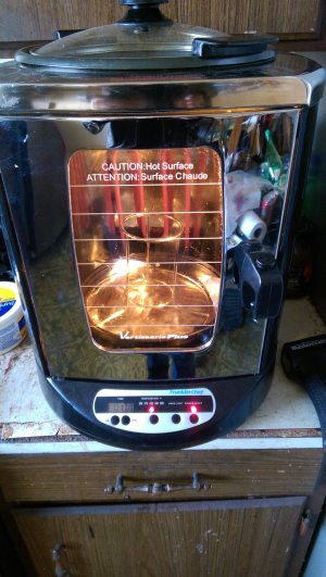

There are two ways to effectively PC bullets, the "shake & bake" method that requires the Value village oven & an old margarine container, this is the least expensive, $1 worth of powder will easily do
500 slugs ( as opposed to GC at $50 per thou).
Second way is with a store bought electro static gun...adds about $150 to the operation (provided you already have a compressor).
The advantages of PC over GC are multiple. I haven't done it but lots of antidotal evidence of guys shooting PC coated cast at over 3000 fps were as wax lubed/GC bullets are pretty much limited to 1700 fps unless you have a very hi antimony/tin content to your alloy.
I have a # of molds that drop GC shanked slugs but just coat them and shoot them as i would any BT jacketed bullets.
