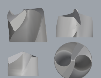

I've been chipping away at redesigning some lost belt grinder attachments the past couple days, and downloaded a drill bit model from McMaster to stand in instead of modeling one from scratch.....Something about this one though made me pause.....Not sure this is going to work the way they think it will.....That's one way to split a point though....lol
I found it pretty amusing......😀.
I do find their CAD models to generally be pretty good. Very nice time savers when designing stuff. Whoever modeled this one though needs to sharpen in that way and try to drill a hole with it. 😀
Extreme negative rake! Maybe a 'day after the football party' CAD design LOL. They provide a great 'free' service so I'm sure if you politely pointed out the issue they would correct it. I'm surprised to even see it as a an available model, but I have not had a reason to use those yet.

Never thought about reaching out to McMaster for correction actually, just posted in fun. The tip is just a cone as well, no cutting relief. Was amused that the split point is actually 135* and the std is 118* though.

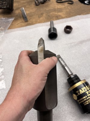

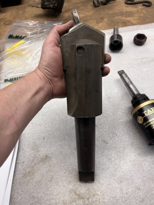

How about this honker?
(I think that shank is MT5, for scale)
View attachment 69280View attachment 69281
Stuart, that’s quite the spade drill! Bring it along, maybe we can try it out!
