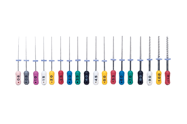

I have files from Grobet and some Vallorbe files both of which make very fine quality escapement files but even they aren't thin enough so I'm still on the hunt to find a proper solution.
Is it possible that endodontic files would be small enough?
I was going to suggest same as @eotrfish AliExpress has some neat dental & medical supplies. Who knows if its up to task for use in your mouth, but maybe worth consideration in hobby use. I have a lifetime supply of surgical blades (once I get through my lifetime supply of Xacto blades)
Thanks for the suggestion, The 06 might work if it's an indication of the dia in mm's but I have a feeling it's not. The thickness top to bottom is the biggest issue. I need files that are no thicker than .01mm top to bottom and I can grind them to that spec on the belt grinder but they are too coarse to cut properly, even #6 is too coarse.
