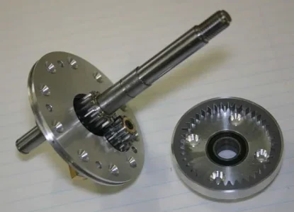

I went down this path evaluating options for the ring gear of my radial. They are not as straight forward as external/spur. Additional factors come into play affecting tooth shape, clearances & other dimensions, some of which also vary as a function of tooth count & pitch. Smaller PD & lower tooth counts are tweaked more if I recall & tolerances become tighter. In the end I decided to buy my way out of the problem, there was more than enough work modifying the blank never mind second guessing the tooth engagement. Not to dissuade you from pursuing. I've seen home shop broaches made and the gears apparently 'work' but the devil is in the details. How well, under what loads, their physical size etc. The formulas are generally available but the trick is translating that special shape into a tool.
