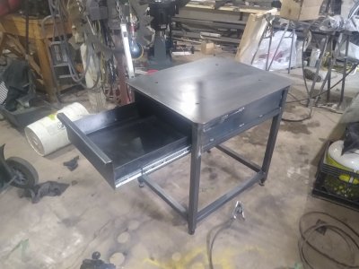

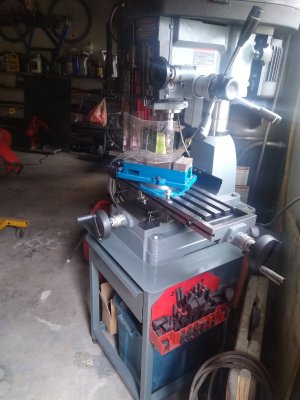

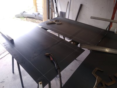

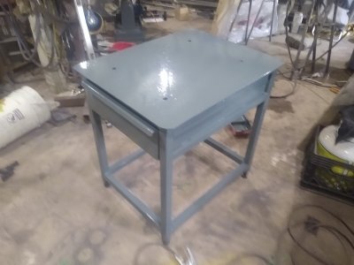

Been working on a couple stands for the king mill/drill and the little south bend, i wasnt about to pay 300$ for the king one, and the little wooden work bench for the south bend wasnt doing it for me. Im not the greatest at remembering to take pictures in progress, but here are some of the ones i did remember to take!
i used 100lb slides for the drawers, riveted to the sides, 3/4 inch structural bolts hammered into the 1.5 inch tube legs as levelers on the mill stand, table tops on both are 3/16 sheet i had left over from a job, and good ol tremclad for the paint....i hate the look of raw steel
Still need to make a few things for the lathe table, a little strut for the wing, a backsplash/tool holder/dust guard, and im waiting on the levelling casters from ali
