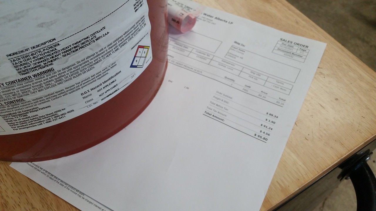

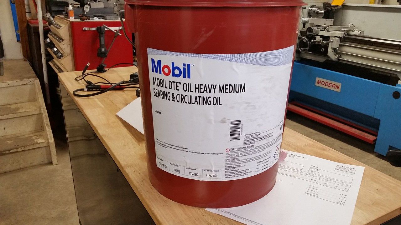

My lathe manual recommends Mobil DTE Heavy Medium Bearing and Circulating oil in the headstock, gearbox and apron. I had been using the same Pro Point brand ISO 68 hydraulic oil as I used in my old lathe but at the most recent oil change I decided to try and find some Mobil DTE. A quick google search for Mobil suppliers turned up the Blue Water Group in Edmonton. I thought since they are a huge commercial lubricant supplier that they would want nothing to do with a guy wanting to buy 1 five gallon pail but the order desk guy said "come on down, we have lots in stock". I had been paying about $60 for 5 gallons of the Pro Point oil and the Mobil was $90 but I wanted to give it a try and see if I could tell the difference. I finally got around to doing my once yearly oil change last week. First thing I noticed is that the old oil must be doing it's job as there was virtually no wear metal on the magnet in my sump. Second the Mobil oil is as clear as water where the old oil had a brownish tint. It's hard to get a straight answer when asking about the difference between regular hydraulic oil and "Bearing and Circulating" oil. Most people say there is no difference but I'm not so sure. I will keep track of any thing I notice over the next year and post my observations here.
