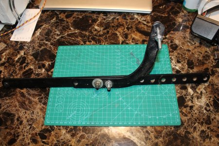

I just happen to have these, found on a walk I could never leave metal like that just lying at the end of someone's driveway.
Free to you if it can help someone out I am in Ottawa, willing to ship it out.
