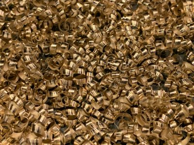

Anyone working in brass? I'm looking for a couple cups of brass chips(shavings) to be used for a bluing tray. (Used for bluing screw and watch parts.)

Yes I took a screen capture of the Clickspring video. A picture always makes a post a little more interesting.
I'm thinking the chip texture is the most desirable for the bluing process. The process involves oxidizing the surface and I believe it gives the surface more exposure to the O2.
One text I read suggested the use of powered marble. I did try this for a while and it did work. The issues with the powdered marble is the powder can pop when heating and small pieces end up on the surface and you can see small imperfections. I'm hoping to step up my game a little.
The amount of chips from my shop do not add up. lol. I'm chucking up a big 3/16" diameter rod this evening for a project.

I just threw these into the scrap bin yesterday— maybe a bit stringy for your use but easy to come by with the shaper. I used to have a couple pound bag of saw cuttings from when I was cutting sign lettering but not sure I still have it. Not exactly in Calgary either, but I’ll still have a look for it.

I'm not sure if those would work. I'd be willing to give them a try if nothing else presents itself.
How thick are these shavings? 1/8" wide? 1/4" wide?

Thats ok. They’re 0.085” wide by 0.015” thick but I actually don’t have more than a half-cup or so right now anyways.
Found the other stuff though — 2-1/2 lbs of leaded brass saw cuttings off the vertical bandsaw. Couldn’t bear to throw it away so I’ve had it for 15 years probably.

I really wish I could say I did these using the Clickspring method, but no. I put a really good effort into trying it the way Clickspring shows in his video and I'm starting to think there is more being done in that video then meets the eye. (Actually he has a couple videos regarding bluing and I see a few problems in all of them).
First off the torch appears to be too small to get the results he is showing. I stepped all the way up to a larger propane torch and I was getting results but not as I had hoped for.
The hands I completed above were heated on a 1/8" thick disc of bronze. The diameter of the disc was 1-1/4". I had to fall back to my old method. I spent far to long polishing and repolishing trying to get the Clickspring method down.
The larger chips Frank sent me are far too big for this work. I did try them, but the results were not good. They might be good to use on larger objects. The smaller chips were nice. I washed them in acetone. Dried them. The idea is to even out the heating and control the rate to obtain an even blue color across the whole hand. (Due to the different structure in the hand shape some areas heat faster then others and the blue ends up being a range of colors.)
Using a small torch gives the heat to a very localized area. Even with the chips it takes time to spread that heat evenly. A large torch works a little better but the rate is faster and it is easy to overshoot the color you want.
If I had to guess. Clickspring is using a digital controlled oven or heat source.
I would like to pass out a great big THANK YOU to Frank for supplying me with the chips to try this process out. When I get some more time I'm going to revisit this and try them again. I have a few ideas that might help me get to the Clickspring standard.
