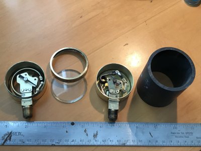

I can actually get the tubular stock from Online Metals in the USA. Exactly the spec I need. But it's $240 for 12 inches!!. I can buy a small forge for that money. And I have lots of scrap brass stock in my shop. And so sand casting rough tubes, then turning them is probably the better option. Steep learning curve to climb though.

I've done the calc's and yes, you're right. Each bezel is about 3/8" high(wide). So I figured about 12 to 16 bezel could be machined from a 12" piece. But I'm a complete novice (so <12 (hah!).
But I've got a lot of scrap brass in my shop, that cost me nothing.
Here's a picture to give an idea. The left one is a complete, but old, gas regulator valve. The one on the right is new, brass body but it had a plastic, one-piece bezel/face. AND the piece of ABS I just pulled out is the exact size of the rough brass tube I'd need to machine. So I'm thinking to use the ABS as my pattern in a sand casting and get a cheap propane forge from Vevor. I'm retired and I've got extended healthcare :).
If you have lots of scrap brass it can always be sold to a local scrappie and used to purchase the proper stock.
It will take considerable time to machine and polish each bezel. If $10/bezel for material is a concern then what is your expected hourly wage to get the desired selling price? Or is this only a hobby?
Take lots of pictures :)
Dan Dubeau
And by coincidence, A piece of ABS pipe happens to be the near-exact dimension. Use it as a pattern. A cheap forge from Vevor, casting sand and lots of learning (and propane).
Now you're talking :D
One thing I want to experiment with when I get a bigger propane/waste oil foundry going is centrifugal pipe casting. In all the videos I've seen, the equipment is very easy to make. The knowledge required to get good results, can be learned, and gained through a few trial and error castings, but it doesn't look all that difficult compared to sand casting and pattern making.
