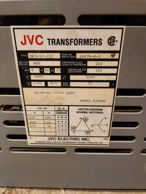

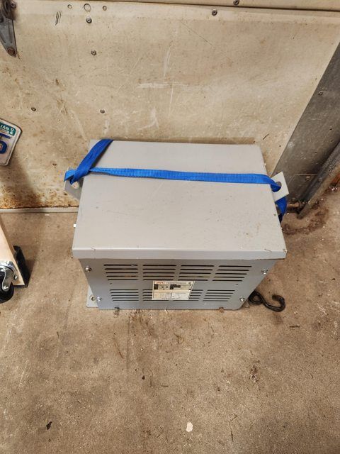

So, an unexpected 5hr door to door kijiji roadtrip yesterday netted me this guy.
I think it'll work fine (would love to hear opinions from those more experienced though?), It has multiple taps on the high side, so I'm hoping I can get what I need out of it once it's hooked up.
