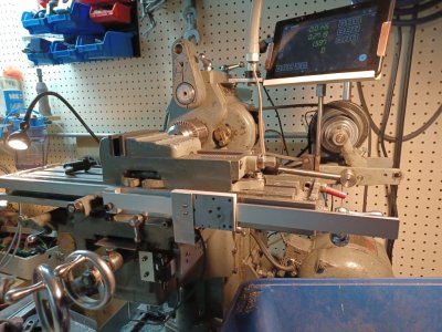

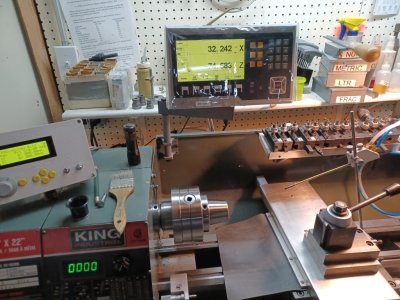

I had a Touch DRO with iGaging scales on my lathe. Irritating to say the least. Scales needed to be isolated from the frame (motor starts would sometimes make the readings jumpt) and the scales lack of resolution were also irritating. Coupled with Yuriy not updating/fixing the sw for 3 years I made the switch to glass 1um scales and display from https://www.aikrondro.com/aikron-dro-products/ (This is the same display that Stefan G now uses). They respond quickly and thoroughly to queries. I was faced with buying a new interface due to the glass scales. Aikron was a bit more expensive but I was more certain of getting a solid product.
Of course just after that Yury finally issues an update (Beta) :) So I moved the TouchDRO stuff to my Atlas mill where it is good enough. I made my own interface, easy with the iGaging scales.
One thing that TouchDRO doesn't support afaik is the absolute position marks on the glass scales. On my Aikron this lets me use the SDM tables to calibrate tools. Some of my tool holders have numbers now, I calibrate to an absolute position on power up, and then the X offset for those tools is automagically set, give or take a few microns. If it really matters, I recalibrate the tool before use. Set the SDM to the tool number and things are lined up for accurate cuts. An added bonus is that I can now easily drill from the cross slide, setting the chuck on centre is a matter of winding the crosslide to 0.000 for that tool.
