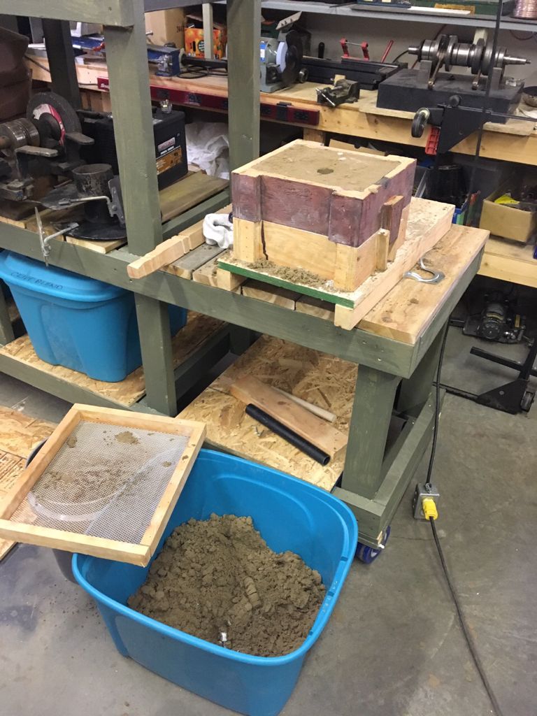

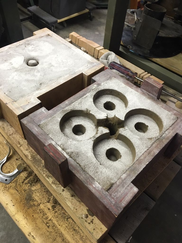

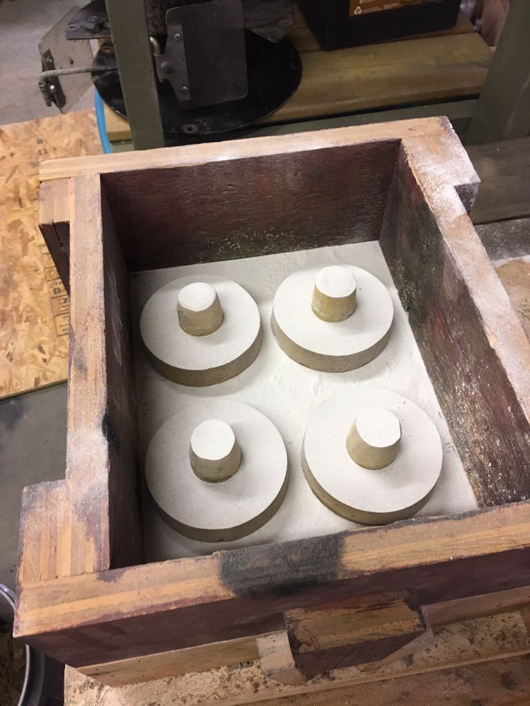

For those who attended the meetup today in calgary this will provide some better visuals to the sand casted levelling feet that I based my presentation on.
For those not in attendance , I recently dusted off my sand-crab coat and decided to do a quick project to make some levelling feet.
I finished two of the feet on my modern 14x40 and two on my 114 year old Von-Wyck lathe.
Picture 1 - making the Molds
Next pic, ramming up patterns
Removing patterns
Ready to pour
Poured
Shaking out the sand
First look
Von wyck at work
Finished production

Nice! That sand looks like it is fairly course on the casting though is it playsand?
The sand is an oil bonded blend I picked up from a guy near Clive AB
Not sure of the sand genesis , but it mulls up nice .
For fine finish I use brand name petrobond
