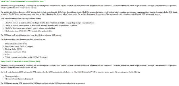

According to the information I found here's how it should work:
After questioning my wife about this she stated that this has happened intermittently before. She will then manually turn the radio OFF before exiting.
So making sure the radio is OFF before exiting is the simple fix. But if I understand the info above shouldn't the BCM have shut-off the radio within 10 minutes or after sensing the battery voltage had dropped to whatever predetermined level? If the BCM doesn't shut the radio OFF for any of those reasons then maybe it's not receiving a signal. In that case would I be looking for a broken wire, maybe a bad ground, that is creating the intermittent issue?

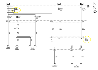

RAP Modes Schematic 2008 Chevy Uplander
Maybe I am not looking at this correctly... but if the vehicle is shut OFF then the RAP relay should be energized which signals the BCM that the RAP relay is energized? If the signal is not sent that the RAP relay is energized then maybe the BCM doesn't acknowledge the door opening, 10 minute countdown timer, battery draining...???
Maybe an intermittent RAP relay issue?
