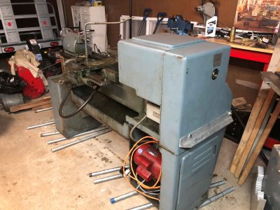

At the beginning of May, I bought a 13" Leblond Regal from GC Surplus. It came out of the one of the National Research Council's machine shops on at their Montreal Rd. location in Ottawa. Getting it home was a bit of an ordeal, but I'm not going to rehash that story as you can read it in this thread.

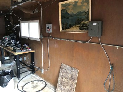

My first and most time consuming challenge was that my garage was only wired for a single fuse worth of 120 V. It took a bit of time to get exactly what I wanted figured out and then to get an electrician over, but in the end it wasn't a major issue. The electrician I ended up hiring is a friend of a friend, so he let me help him out on the job to save a bit of labor time.
What I ended up deciding on was a small subpanel in the garage with a 240 V outlet to run the lathe on and disconnect switch for the outlet. I thought it would be a good idea to leave the lathe entirely unpowered when it's not in use and covered.
It took me a while to decide on what approach I wanted to take to get the new toy running. My perfect solution would have been to generate 575 V 3 phase somehow (I looked into a rotary phase converter + transformer setup). It took only a cursory look into this to make me dismiss it as unnecessarily expensive for a hobby budget. I considered a VFD of some sort, and if I had known about voltage doubling VFDs at the time, I might have gone that route, but I really wanted to have the original controls work as they did from the factory, and my understanding of VFDs is that it's a bad idea to put anything between the VFD and the motor. Knowing what I know now about how simple the rotary switch on this lathe is, I probably could have managed it relatively easily, but that's neither here nor there.

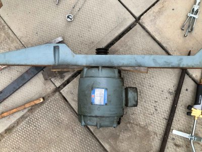

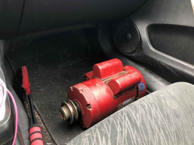

What I finally settled one was replacing the original 2 HP 575 V 3 phase motor with a 2 HP 240 V single phase motor. I was able to pick one up a motor off of Facebook Marketplace in Cornwall for $200, which has the same shaft length and diameter, and a similar enough frame to work.
The Leeson motor I ended up with is a farm duty unit, which from the barely-more-than-zero research I did on it, seems to be about 20 years old. There was a similarly spec'ed generic Chinese motor much closer to me, but I ended up going with the Leeson on the gamble that a name brand motor will be more reliable. Time will tell.

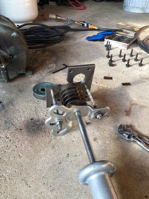

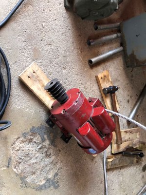

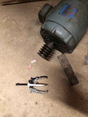

@brino and I removed the motor from the lathe during our initial futile attempts to unload the machine from his trailer, so the first order of business was to remove the motor pulley from the original motor.

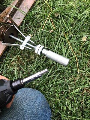

Attempt #1 ended in a broken slide hammer and a broken bit driver
Attempt #2 ended with some broken hardwood wedges, but nothing worse than that
Attempt #3 was also a failure

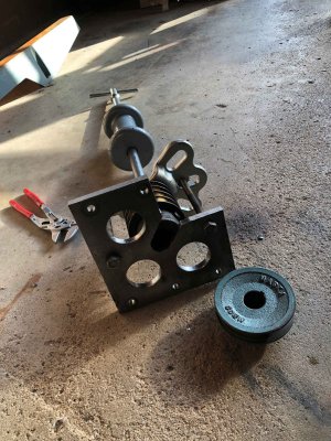

Finally, attempt number #4 with a borrowed wheel hub puller was successful. At each of these stages I tried judicious application of blowtorch, but it took several minutes of blowtorching in addition to the large slide hammer/wheel hub puller to eventually get the pulley off. IMG_4807.JPG
The plate at the bottom of the puller was a random piece of steel I had lying around, which already had holes, which were close enough to be tapped for the threaded rod.

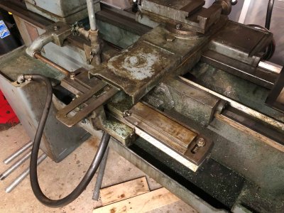

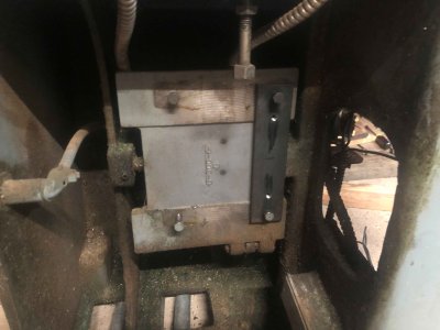

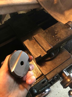

After getting the pulley off, I took the opportunity to clean up the taper attachment while I had easy access to the back of the lathe. This machine is completely covered with a mix of dried coolant, which is surprisingly hard to get off. In spite of that I managed to get it cleaned up nicely.
If anybody has any suggestions for cleaning up the dried coolant/oil/plastic swarf I would appreciate any ideas.

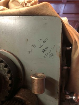

Based on these maintenance notes, I'm guessing that this machine wasn't used much after the early 90's.

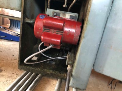

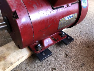

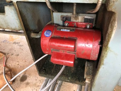

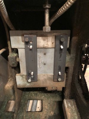

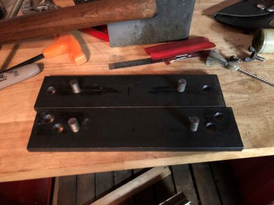

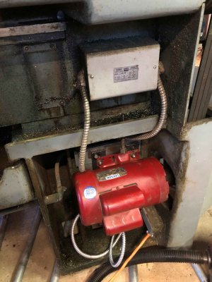

Getting back to the conversion, I had to make a couple of adapter plates to get the new motor to mount to the old motor mount cleanly. A bonus to going to a motor with a smaller frame diameter is that once the Leeson is mounted to the adapter plates the motor can now be installed or removed with a ratchet instead of a crescent wrench.
The studs for the new motor mounting were made from cut down threaded rod, which was peened into place.
The new motor is pretty much a perfect fit.
The new pulley was put on with some more judicious application of blowtorch.

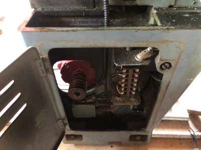

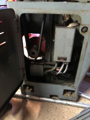

With the motor mounted the rest of the work is electrical. I'm going to take Quinn from Blondihacks' advice and not show that, but as you can see from that last picture the main switch is pretty straightforward. Adapting that to single phase wasn't a major undertaking.
Still to do is wire up the spindle brake for the new voltage and finish buttoning up the machine. At the moment the brake is entirely disconnected and nearly every cover is lying on the floor in my garage.

Spent some time tonight wiring up the spindle brake and buttoning up the electrical. No more bare wires! Spindle brake works, although I had hoped that it would completely lock up the spindle when stopped. In some of the higher gears it only has a drag, instead of being fully locked up. Still it's nice to have it stop relatively quickly.
I was able to eliminate the step-down transformer, which originally generated the 120 V AC for the brake from two legs of 575 V. The resulting setup looks like it could have been factory if not for the grim around where the transformer used to be.
The final electrical is a very clean conversion. No extra boxes hanging off, or mounted to the wall behind the machine. From a user's perspective the controls are identical to factory, and if you didn't look too closely at the back side, you probably wouldn't notice that it's been reconfigured.

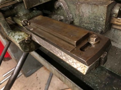

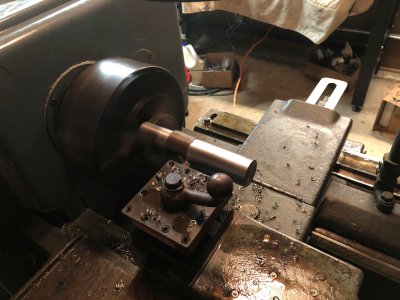

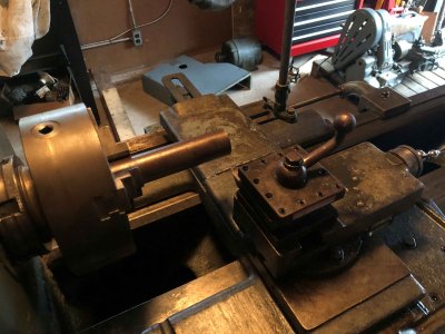

While this is probably not going to be my final tool post solution, it should do fine for the time being. This is an Enco 4-way tool post, which I was given by my uncle's neighbor last weekend, along with a Myford ML7, and some other misc tooling. By sheer coincidence, the tool post was close enough to fitting the Leblond's compound that I couldn't be bothered to milling it and just filed to fit instead. The t-nut that came with it fit the compound without any modifications.

So far I've been very impressed with the cutting performance. The piece of steel I'm messing with here is a super gummy crappy piece that I picked up somewhere for cheap enough to not worry about wasting it by aimlessly turning it into chips. Even with the terrible quality steel, the Leblond was able to take remarkably deep cuts without chatter and on mock finishing passes it produced a respectable finish.
The upgrade over the little Atlas is really staggering. I made an expanding mandrel out of that same piece of steel using the Atlas and it kept grabbing on me and was a struggle to get a good finish on. With the Leblond the grabbing issue went away entirely, and the surface finishes were as good as I ended up with on the Atlas, but with less effort. I've used proper lathes before, but not in several years, so going back to a truly ridgidly built machine is really a marked difference.

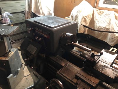

Oil's changed, Electrics are functional, time to put the belt/gear cover back on. Definitely looks better that way
Now that the machine is back together and the clean up/conversion is done for the time being, the next thing to do is move it out of the center of the garage to its more permanent home. At this point, the machine is totally usable except for the coolant pump. I'd still like to get that going (partly to empty out the coolant that's still in the tank), but that can wait for a little longer. With that being said, that means it's almost time for me to part with my little (by comparison) Atlas 10F. I'll probably post it here in the classifieds here once the time comes, so if anybody is interested in a good starter lathe and is in or near Eastern Ontario, keep an eye out for that.
