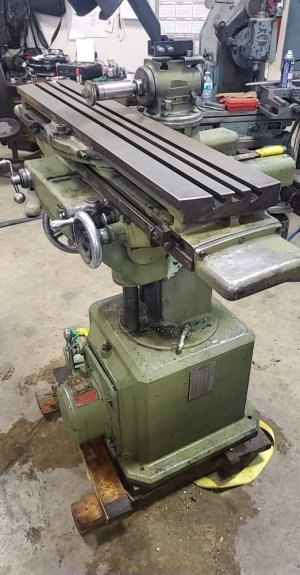

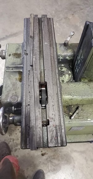

Hey everyone,
Last week I was lucky enough to come into a leblonde no2 tool and cutter grinder.
It's in pretty nice shape. And of course I have to shred it to clean / replace broken or badly repaired parts / paint it before I even get power to it
Seems best that way, to me anyway... once I start using something I don't like to stop and tear it down unless it's terminal.

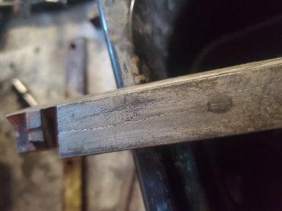

Found a couple ugly spots, forgot to take pictures of it all. Need to rebuild a couple of the shafts, where the rapid traverse handles slip on, as well as where the table cross feed screw comes out the back. Also have a slightly cracked gib but I think I'll leave that dog lie.
Going to be a fun one! Looks like minimal wear even though there was a fair bit of grinding slag packed into a few places you don't want it.
Any advice or resources for parts/manuals appreciated!

That table has two gibs, one from either side - do I see that correctly?
I would at least stop drill the crack in the gib to prevent it from migrating.

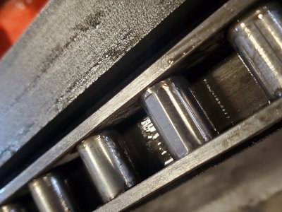

Can one replace the rollers individually? Or is it a whole assembly?

Yes it has 2 tapered gibs adjusted on each end of the table.
That's a good idea to stop it cracking, although i believe it to be from abuse and not normal stress.
The rails that hold the rollers is pinned in 3 or 4 places, removing one or two pins would give access to the damaged rollers, I think im going to remove the damaged ones and slide the neighboring rollers in to fill the gap. I might make a replacement and throw it on the end, we'll see how they measure up.
I sure wouldn't want to buy the roller assemblies, I'm sure they cost more than I paid for the machine if they are still available.

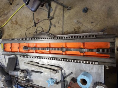

First attempt at anything other than rattle can paintjobs, still to decide on paint type and color but it's coming along. Lots of lessons along the way on this one.
Also shaped and polished the top chamfer and top if the base, for some sucker for punishment reason.
Will continue to add to this thread, can a moderator move this to active projects perhaps?
