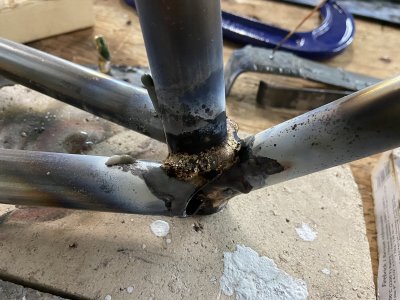

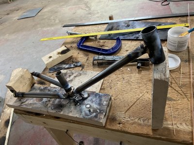

A couple updates to the balance bike project. I built a quick jig to attach the “chainstays”, and picked up some new files which improved my copes quite a bit.

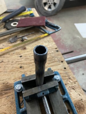

I made a fusion weld on the bottom of the steerer tube to attach it to what will be the centre part of the fork; this also gives me a nice lip on the other side for the headset bushing to ride on.
my first attempt at a fork didn’t work out perfectly, I’ll post the second attempt when it’s completed later this week.
another time I would buy smaller tubing for most of the frame, this stuff is .875 OD and it has a slightly beefier look than I would have preferred.
