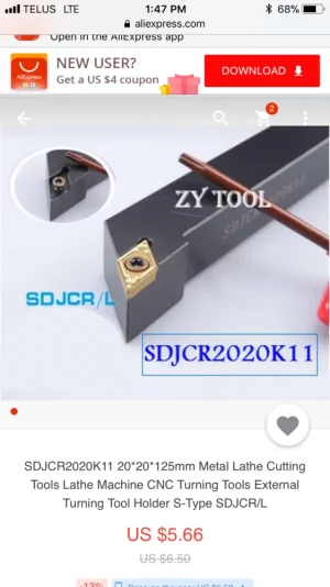

They do as they are supposed to, and give more versatility but the real question is how many different types of inserts are you looking to find a home for? And how many different sets of holders for each type is going to be enough lol.
That insert is called a DCMT and it is one of the most versatile inserts in existence. It has a 55 Deg angle. I have a sandvik .5" dcmt holder that takes an insert with a .25" inscribed circle. I recently tried ordering some Chinese VBMT tool holders with a .250 inscribed circle but the dam inserts don't fit well at all. I'm probably not going to use them I'll just order something else. The VBMT has a 35 Deg insert and is Best for finishing profiles with an undercut.
I use that style myself & I like it. It started innocently. I found some uncoated ones with sharper nose radius off Ebay or Ali specifically for aluminum. They cut like a dream & make a nice chip. My mainstay was CCMT 060204 which work perfectly fine, but at the time I could only find brand name inserts at like 8-12$ a pop or so from the tool catalogs. So now I just use my CCMT inventory on steel & DCMT on aluminum which is kind of silly but the way it worked out. Nowadays I think you can find either/or in any coating/radius/chipbreaker from offshore discount places so could probably pick one or the other as a standard.
DCMT is narrower & allows you to get into nooks & crannies of shoulder corners a bit easier which has come up for me occasionally. It has a bit more stick out so is maybe a bit weaker, but I don't think either of these are meant for heavy hogging. CCMT also matches a very complete set of boring bars so has more utility from that standpoint. Both styles only use 2 of their 4 corners although I have seen the odd commercial holder (or self made) that uses the odd corners which I believer are shaped the same. Some people say 3 cornered inserts are better from that standpoint, but again, how much for that type of insert & corresponding holder if they are not as common? My shanks are all 5/8" or close metric equivalent so I cant speak for big boy ones.
Things have evolved quite a bit the past 5 years. When you can buy a toolholder from China with free shipping for the price of a single insert from NAm supplier, it swings the decision. Some people say offshore tool holders are crap which some may well be. I've cut some of mine up or otherwise modified them & I think they must be reasonably tough stuff like 4140. So if I'm not pushing them hard or in production, I think they are decent value. Some of the screws can be a bit cheesy, others are fine, it really varies. OTOH some of the 'big name' tool holders have slightly different (proprietary?) insert screws or clamps which makes them PITA to replace.
I bought two tool holders for DCMT inserts from a guy in High River. I paid way too much for them, but they cut really well. As above, it is easy to byt quality inserts for affordable prices in DCMT (And CCMT, but I don't use that much).
I just started using Bangood this fall. Very happy with the carbide I've gotten. This is from a die hard Kinnemetal guy. Been using KM for 30+ years, but at $2 per innsert, I can afford to give Banggood a try, and it has paid off, so far.
I always assumed Bangood was more or less the same source suppliers as Ali, but in all honesty have not tried them yet. I remember on one particular tool holder it even looked like the same inscription & price was comparable. Do you guys find shipping times or transaction reliability any better on Bangood vs. Ali, or any other advantage? I always check Ebay too just for the heck of it. Recent example on some inserts was about the same price but ebay was free shipping 15 days vs. Ali was free shipping but 30-45 days. Seems to vary like crazy depending on what you are after.
