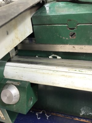

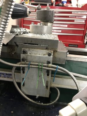

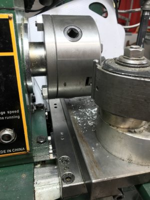

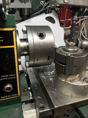

Here's my lathe DRO setup.
To start, using the offset fixed tool post, I can place a tool bit past the end of the chuck. The cross slide can contact the base of the headstock.

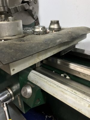

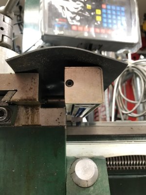

Cross slide DRO is mounted on the tailstock end of the cross slide. I lose about 3/4" of tailstock travel.
I don't have big shroud over it. On the top of the cross slide I have a chunk of 1/8" rubber sheet. Cheap-n-nasty but saves my knuckles. allows access to the gib screws. When the rubber gets torn up I cut a new one. The glass scale is protected by a full-length aluminum box that came with the scales. Maybe 3/16" gap between the inner face of the box and the glass scale. I originally had the scale on the headstock side, but after I scalloped it with a chuck jaw I realized the tailstock side is much safer.

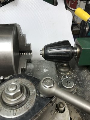

Yes, the tailstock can contact the box, but how often do you slam the tailstock into the cross slide? If you do, maybe metalworking isn't quite your ball of wax...
Loss of tailstock quill travel? Photo is tailstock extended about 1/4" from fully retracted. Maybe 3/4" from chuck tip to tip. No problem using a centre drill.

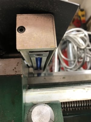

and a photo of the z-axis DRO attachment. Reader is 100% covered, and the connection to the cross slide base is below the level of the movable slide.
Ouch, that hurt! Then again, I never did aspire to collecting wax.
So my confession - I do this ALL THE TIME - ON PURPOSE!
Especially when drilling deeper holes. I hate cranking that tailstock wheel back N forth to clear chips and add cutting fluid. So I put the quill in the most rear ward position, then the tailstock up against the cross slide, and the saddle forward until the drill is just about the hit the part. Then drill away using the tailstock hand wheel. When it's time to clear chips, reverse the crank just one turn and then pull the tailstock back, then clear, add cutting oil, and push the tailstock back to the cross slide, turn in one crank, and resume drilling again.
So what is this ball of wax all about? Never heard that one before. Ball of yarn yes, but not wax.
What the heck are you doing that puts your knuckles at risk?

@whydontu Thank you for your great pictures. I have gotten myself confused by what I am seeing, and I'm sure it is on me. Is your scale for the DRO for the corss slide on the chuck side of the apron, or on the tailstock side? it looks (to my poor vision) that you have 2 scales - one on each side of the apron?
whydontu
I Tried, It Broke
Your vision is probably ok, I’m the worlds second-worse photographer. My mother was the worst, thousands of photos and nary a top of a head to be seen.
Scale is on the tailstock side of the cross slide carriage.

Clarifications:
During the Dad-Of-Justin administration, I worked for a plumbing wholesaler. A very dim-witted co-worker was loading a toilet bowl and tank into a customers van. Toilet fell, shattering into a zillion shards of pottery. Co-worker went over to the boss and explained that the toilet came in defective. He did this loudly enough that all employees and nearby customers heard him. Boss took co-worker out to the loading dock, said, and I quote, “son, I don’t think plumbing is quite your ball of wax. You’re fired”
I use the tail stock the same way as you. But my guess is, like me, you don’t slam the tail stock into the carriage. I suspect it’s possible to mangle the DRO cover, but I doubt normal use would be capable of deforming a 1/8” thick anodized aluminum cover the 3/16” it would need to travel before it hit the actual scale enclosure.
Previous iteration of DRO scale protection was a sheet metal cover located exactly the same as the rubber sheet. Moving my hand from cross slide handle to tailstock inevitably meant knuckle hitting sheet metal.
Bed DRO is located on the back of the bed. See explanation of photo quality in previous response.
My DROs has fairly slinky armored cables. The bed DRO cable is looped 180* so there’s no strain on the cable/reader joint. Cables travel up to the DRO display post, so just lightly drags across the bench. It’s survived the last six years, should be OK for a while.
DRO display is in line with the headstock, it just worked out that way. I usually have a clear plastic cover over it. Even the cheap DRO displays are rated IP53 for dust and water ingress, so cutting fluid is a cosmetic issue. If I think I’m going to be using a lot of cutting fluid, I grab some Glad cling wrap.
Never! Too afraid of buggering up the carriage lead screw!
I'm thinking a bumper through the cover is the way to go here.
