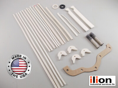

A SB 10" heavy would be a good lathe to start with if it hasn't been abused, there seems to be a lot of overspray so someone in its past did a rattle can restoration on it. You really will have to tear it down, older SB's have oil reservoirs underneath the main bronze bearings with felt wicks that bring the oil up to the bearing surface. A lot of the time those wicks are long gone.
There's a guy on ebay that sells a felt kit for every SB made and it's well worth the $30-40 buy it, he also has a nice little "How to restore your SB" hand book which is good as well.
As mentioned above there are lots parts floating around for sale for these machines and there is even a dedicated forum on Practical Machinist forum just for South Bends.
Ooo, his prices have gone up since I last bought one,
