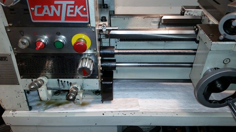

My question is, why does his lathe stop on a dime like that? I don't have a brake, mechanical or electrical. But when I power off I have to allow for wind down deceleration. Do some machines have inductive off or something? His switch & knob looks different.
I'd agree he's running a vfd.. which you can get almost instant stops if it's set up right. You can also put an electromagnetic brake on yours and have it wired to disengage when you turn the spindle on if you want to mimick what he's able to do. Or put a vfd and 3 phase motor on.
I'm at the infancy noob evaluation stage of VFD. I can certainly see the advantages though. Links below show some added proximity stop enhancements.
What I cant quite get my head around is how standalone is a VFD lathe conversion. I just assumed (hoped?) you replaced the the existing motor with VFD motor, programmed the VFD control box & away you go. Leaving the internal electric boards & fuses bypassed & unscathed. But looks like some VFD systems tie into the existing electrics, maybe to utilize the carriage FWD/REV lever? I don't have flood coolant pump, so that simplifies things. Its basically on/off fwd/rev & mechanical speed selection. The carriage lever is certainly handy & almost hard-wired to my brain now, but I guess if I had to flick a different switch that wouldn't be the end of the world. I was toying with the idea of getting a 110v VFD & replacing my drill press motor just as a lower cost learning exercise. It would give me more rpm control & save me messing with belts which I by & large ignore out of laziness.

Peter, I think your lathe does have a "jog" button. It's the green one beside the E-stop. I use mine occasionally.
