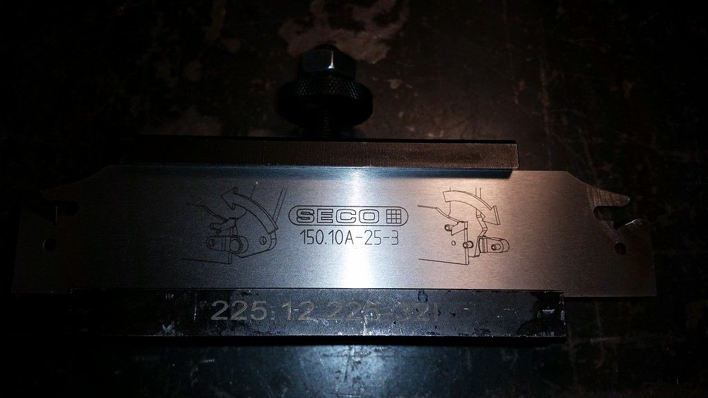

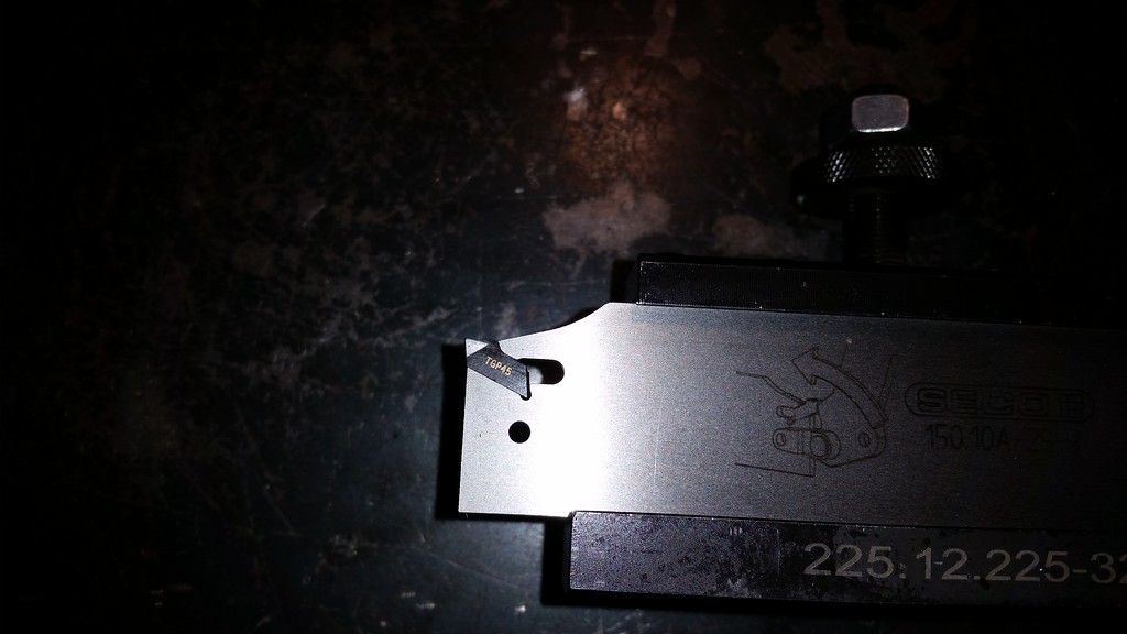

I have a nice Seco parting tool but the inserts are crazy expensive. They are marked TGP45. Does anyone know if I can buy inserts from someone besides Seco?

I'm using MGEHR system John in 2 & 3mm width. I was sampling toolholders from here & there, coated vs uncoated inserts so a bit of a mish-mash sources wise. I also had a requirement for both left & right handed shanks which these have. This may have been one on of the sellers but I'd have to check my notes.
https://www.ebay.ca/itm/MGEHR1616-1...-MGMN150-G-NC3020-NC3030-insert-/152389905457
Ali link. There are many! Anyways shows a chart of shanks & cutter combbos. I always just get neutral inserts.
https://www.aliexpress.com/item/32842061584.html?spm=2114.12010612.0.0.7aa45e5aJIlQzR
I was actually fully expecting them to be cheesy duds but its not like I was risking a lot of dollars. They are my go-to parting tools now. The one I reserve for aluminum is as sharp as when installed, its done a lot of work. I haven't done heavy plowing in any tough steels but I use the regular yellow coated ones on mild steel like 1018 & 12L14. They also did a nice job on 303 SS. Occasionally I break out a HSS blade if I have to grind a profile or oddball width so still nice to have. The other option in HSS is the T-blade which personally I prefer over the double taper type. The problem is usually the knockoff HSS toolholders can be iffy. USA ones are good but expensive new.
