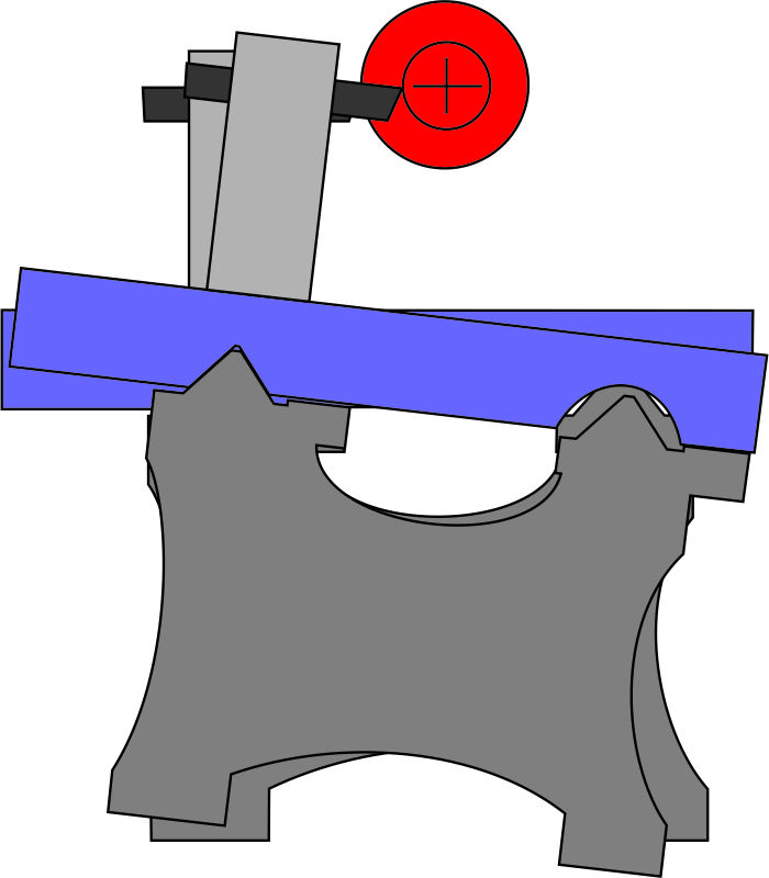

You've probably understood this already but it is easy to confuse the idea of getting a lathe level and getting a lathe straight. A level lathe is good place to start but being level or not doesn't really impact how the lathe performs, (there are lathes on ships), being straight is what really matters.
A machinist level may be too sensitive for basic leveling of a lathe but that sensitivety is needed if you want to make sure the bed ways are straight.

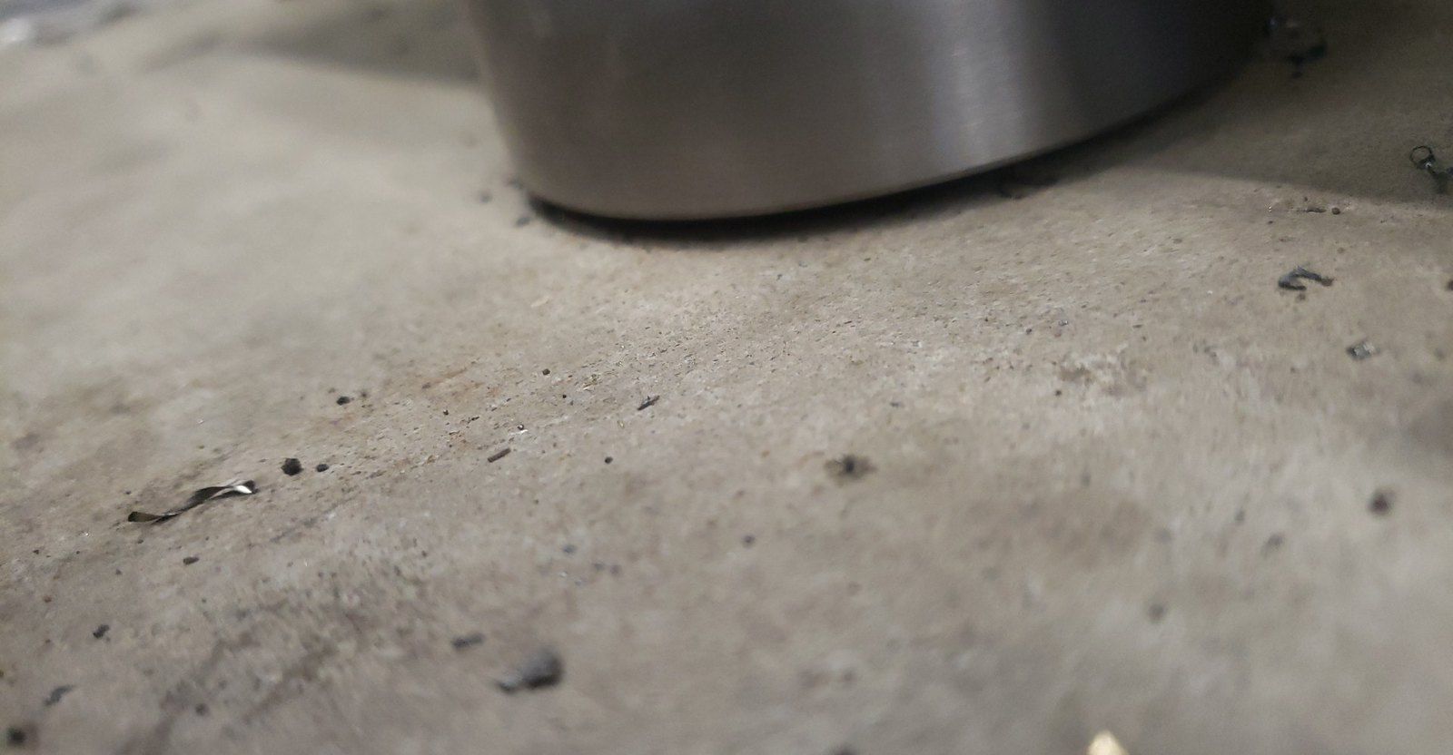

Sponge pucks are no good, need hard rubber pucks. A jack screw/locking nut with a rounded point into a steel plate with a drilled divot would work too, and be lower.
DPittman is correct, level is not the idea. Its about taking out the twist to make it cut straight. Sometimes level doesn't even work if you are running coolant and need it to flow towards a drain, etc.
to sensitive? Not sensitive enough....ideally you want the master precision level but unless you are into reconditioning (I am) its a bit of an extravagance. You can do the same with a machinist level then some trial and error.
You'd do well to incorporate some levelling bolts as shown above. You need that sort of sensitivity and its not set and forget, things shift over time, concrete moves etc so a convenient way to tweak it is really helpful. Also as noted above, level itself doesn't much matter, its just a convenient reference against which you are trying to remove twist.
After using the level, I check it by machining or sweeping something just held by the headstock. Involving the tailstock confuses things....leads to "is it twist or tailstock alignment?"
If its not clear why twist is the enemy, here's a diagram I did showing how twist affects diameter

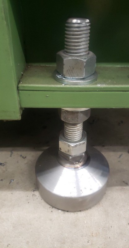

Thanks guys. I am going to incorporate an adjustment into each corner. I need to lift it first though. I just welded up my device shown in the mockup and will see if it works. Get back to you later.
My jacking rig worked out great. I did need the block of wood inside the recess to prevent the jack from pivoting out but otherwise, made it very easy to lift the unit. I used 5/8" bolts cause that was the largest that fit through the hole in the bottom of the stands. I turned a taper on them that more or less matched my 5/8" drill bit, then made small pads to sit on the floor with counter sink divots in them (Thanks @dfloen for the tip...no pun intended..) The lifting plates were made from 1/2" plate from my scrap pile. I welded 5/8" nuts in as I did not have a 5/8" tap and honestly, figured this would be faster and easier.
I think they will work out ok. Will start the actual leveling process tomorrow. As replies mentioned above, I plan on rough leveling it, then start making cuts and see where I am at.

I had good success yesterday leveling the lathe. I started out making sure all feet had weight on them, then leveled with a carpenter level. I then started making cuts. First one was tailstock=1.176 and chuck 1.173. Made 4 adjustments, then realized that I probably should tighten the jamb nuts. I then made some more adjustments, then realized that I had the live center in...:rolleyes: but finished up anyways to see what difference it might make. I was able to get it bang on, now at 1.1062 both ends (over only 8")
I then put the dead center in found it off a little. Maybe was me though. I went through the process again and was able to do two repeatable cuts at both ends equal. I am pretty happy with that. A new experience for me.
I will probably put a long bar in sometime and see what the difference will be over the entire length or at least, longer than 8 ".
I could not imagine trying to do that via shims. The feet were sweet! :)
