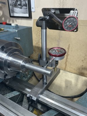

While working on the Eureka relief tool, I was having all kinds of problems with the DTI mounted in one of those wobbly magnetic indicator stands, teetering on the edge of the ways. The solution was this rear mounted indicator stand, which is sturdy and rigid by comparison.
The base clamps across the way, and as you can see it is relieved to match the cross section. Before cutting metal, I measured the ways, sketched the profile and printed a 1mm thick pattern to test the fit.
The DTI mount allows tilt, swivel and height adjustment. The indicator mounts horizontally face up which is really awkward to see, so I made a swivel and mounted a small stainless steel mirror. Works like a charm.

Wow!!! Some Mighty Fine Work and Ideas there.
I think indicator holders and setups like this should be a focus for the entire membership. You can't machine what you can't measure! And you can't measure what you can't see!

One of them was to add a large 1/4" plate of steel here:
The thing is that cast iron is a poor place to put a magnet. But a magnetic indicator post will mount onto a steel plate with strength to spare. The plate needs to be fairly thick so the magnet is effective. 1/4" plate works just fine. Sheet metal doesn't.
I love your gimbals. Did you make those? Do you have drawings for B and C to share? I'm in the middle of a project I've been doing for several months now and I could sure use some gimbals like that! Where did you get the mirror?
Did you consider a lip at A? A lip would trap the plate at the V way so nothing could come loose or fall. A tightening screw would not be needed.
I'd also add a clearance slot for the back v-way so the fixture could be used on the front v-way too and also further away from the headstock too.

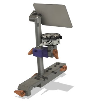

The base is made from 1-1/2x1x12" CRS (PDF attached) it only fits the rear way on the V10P. The front clamping screw doesn't need to be gronked down since the profile is a close fit to the way cross section. A lip would make it hard to remove in this design.

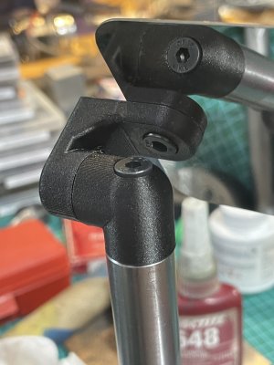

The small parts are made from PETG-CF which has proven to be almost indestructible. The screw threads are tapped into the plastic, and all the joints in the swivel are lightly tightened to allow easy adjustment. Smaller screws down to M3 hold well when tapped into this plastic.
The clamp levers are fitted to the socket head screw to take advantage of the light knurling on the screw head. The hole diameter is about 5 thou smaller and the screw is pressed in. With the correct interference fit, they are very durable. I use these in various sizes on most of my gadgets. Don't forget the top edge radius.
The mirror is made from 2mm stainless steel. They are sold as camping mirrors - about 4-1/4 x 3-1/2" about $5 from Amazoom.

Great work Arbutus. I think there are several people on here working on projects that your knuckle design will fit nicely.

Thank you for the kind words! The knuckle joint is quite simple to print, and I made some from 6061 a while ago for a job but those took a day to make IIRC. 3DP is the way to go and with some fiddling the parts can be scaled slightly to say 25mm dia. If you are seriously interested in some parts, please send me a DM.
