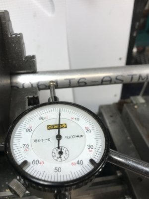

put your round bar in the chuck. put a dial indicator on the cross slide, set the indicator pin as close to centre height as possible. Start the cross slide at the tailstock end of the bar. move the cross slide inwards to set the dial indicator at an easy-to-read zero point. move the cross slide towards the chuck. if you measure without using the compound it removes that possible flex, and will immediately show if the headstock is out of alignment. using round bar with the indicator on centre will identify if the misalignment is vertical or horizontal.
In the photos, I‘ve locked the cross slide by pulling it up tight against the outer travel stop, and I’m not using the compound. The gauge bar is just a chunk of 3/4” aluminum, and it’s reading within 0.0015” without doing any special tweaking.
Rotate the chuck 90*, do it again. Then three more 90* rotations. If the taper is always the same amount, it’s the headstock. if it changes at each rotation, it’s the chuck.

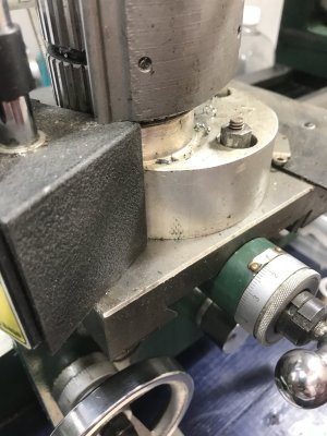

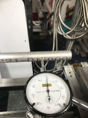

No matter how many times I chuck the last cut piece I get the exact same .005" on the dial when I run it on its side.
Vertical is dead nuts, well almost. @trlvn
