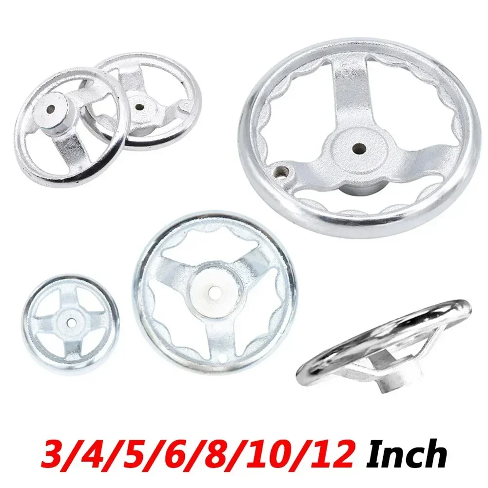

Welcome from SW Ontario.
X2 for Ali.
EBay has them as well.
Depending on how much work you want to do, find a similar Grizzly machine, download the parts manual, and order from Grizzly.
Last time I was there, Busy Bee had a selection of handwheels on the wall.
