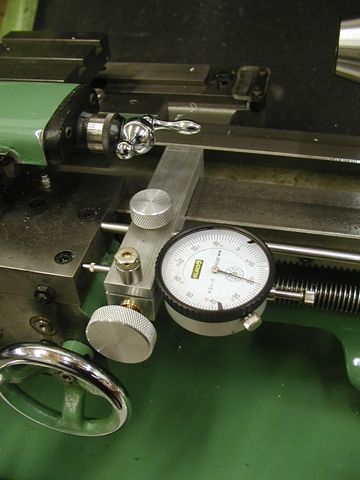

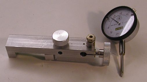

Here's my adaptation to hold by the stem in a split clamp for a flat way Myford:
The knob on the front is the way clamp, the DI is clamped by the aircraft bolt (I wanted the clamping power of the 1/4-28 thread) on top and the other knob is for the adjustable rod that lets you bring the carriage to a repeatable stop.
In this view you can see the hole for the DI stem.
I borrowed most of the design elements from a vee ways clamp I saw on another forum so it should be easy to convert it back!

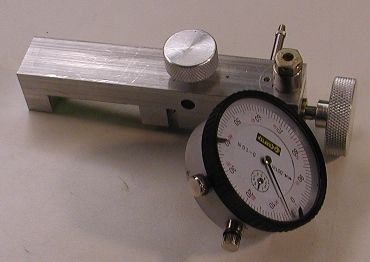

Last photo shows the DI inserted from the other side and tilted for a different view.
This was milled on the Myford in my BM (before mill) days.
