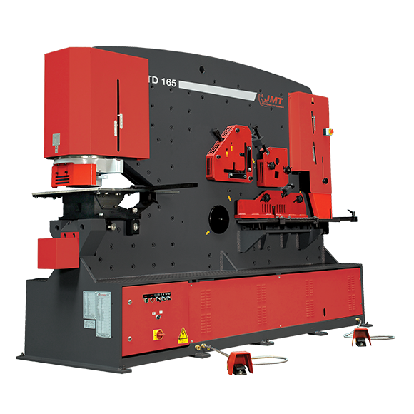

I was reading @PeterT ad for his iron worker that will punch a 1” hole through 5/16 material. That got me thinking what is the maximum size hole with maximum thickness possible? Is there an upper limit to this process? I can’t understand exactly how a punch could make a large hole through thick material and it still turns out with clean edges and not torn.
Practically speaking the largest one I found with just a casual search is the 180 ton jmt USA model which will punch a 2.25” hole through 1” thick steel. The machine looks huge.
Hole size minimum with standard strippers/hold downs is hole diameter equals plate thickness as in 1/2" hole through 1/2" inch plate. Smaller holes can be punched with the use of extraordinary stripper/hold downs and punch supports.
I haven't heard of a limit to hole diameter through a steel plate but the greatest thickness allowed on my online calculator is 1.250".
I have seen 6 inch holes punched in 5/8 steel plate. Very loud.
Most of the units I have seen in general fab shops are typically limited by the lower die for hole size, usually around the 1 1/8 through 1 1/8 material, the guards and lower die holder seem to be the limiting factor. I've used a range from 40-140t and they all seem to max out at 1 1/8 hole from what I remember (the thickness of course varies for the tonnage)
