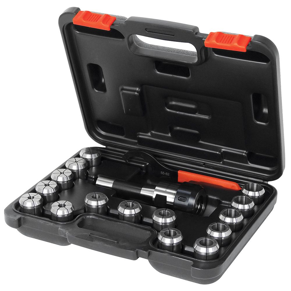

My new mill came with a King so-called "R8 collet set". What it really looks to be isn't a set of R8 collets, but an R8 adapter to hold ER32 collets.
It's missing the 3/8", which of course I actually have tooling in.
Can anyone confirm that this KCS-R8-15 is actually ER32?
Alternately I might just get a 3/8 R8 collet and use that directly. Though the incomplete set is a touch jarring.

Title states KBC? I suspect you have a R8-ER32 Chuck, with collets. Odd that 3/8 would be missing? 3/8 is pretty common.
@PaulL You can ID the ER type series you have by comparing key dimensions to the values in this table: ER Style Collet Table
To my surprise I found that I had inherited a holder and small set of SYOZ 25 collets. My reactions was what the heck is a SYOZ? Apparently, they're also known as RD035 which still didn't tell me much. BTW, if anyone has some loose SYOZ 25 collets gathering dust I'd like to talk as I have some holes in the "set".

I bought a King 9x42 mill which came with a set of collets. I thought they were ER 32, turns out they were SYOZ .
The photo doesn't show the entire collet so its hard to tell, it also states that they are R8 nowhere does it mention ER series.
So be wary

This is the content I'm here for. Yes, the box says R8, but that's only the holder. The collets themselves are certainly not R8. To my limited eye maybe ER32, but I'll check against the SYOZ dimensions now.
