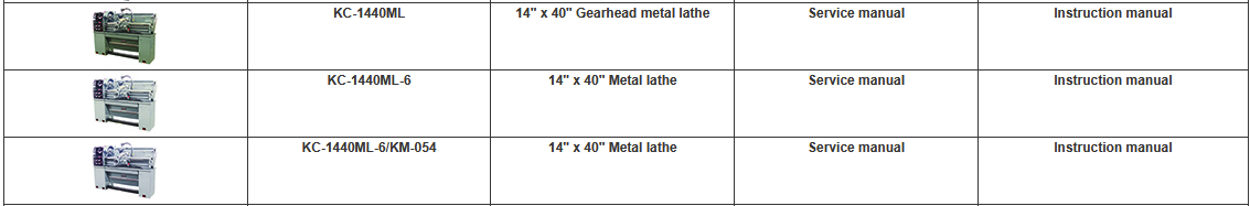

And does anyone have a manual for this machine? I can't seem to locate one with google. And there's a lot of boxes with a lot of parts in them. Might need some clues as to how they go together.
Tom, it may not be any clearer than the photo copied exploded parts diagram that came with the "kit", but I have found another page that is the exploded diagram of the headstock, which I can send to you if that's helpful. I'm a bit afraid that if I scan it it will be less clear than the printed page I have.
