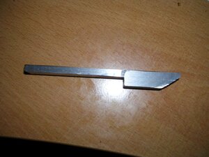

I'm attempting to make a 3/16" keyway broach for use on my lathe. 1.JPG
I'm using a remnant of 4340 I got from @John Conroy (Thanks John!).
I'm to the point of creating the cutting edge and hardening it. At what angle should I grind the edge to? For hardening I was planning on heating the edge to cherry red and quenching in water. Any feel for how long I would need to maintain the critical temperature? I have read 1 hour per inch of thickness. The blade is 3/16" X 1/2". This tool shouldn't see any shock loading. Is annealing necessary?
I guess the other question is, do I harden and grind the edge in or grind the edge and harden it?
Any input is appreciated. I'm exploring new territory here.
RobinHood
I would machine / grind all the angles you need with some allowance. Harden it. Finish grind it and hone the cutting edge.
2*-3* clearance angle is what I would go for. Maybe 5* angle for the cutting edge - more will have a tendency to dig in. Once you have your tool made, try it on some scrap material (the same type that you are going to broach) to see if the tool performs to your satisfaction. Modify if required. It will also show how much deflection you get and how large the cutting forces are.

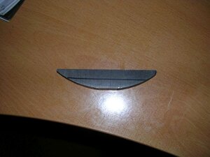

2*-3* ? 20-30? I held a protractor up to the image @Brent H posted and got 20.

A little more progress. It now has a cutting edge and it just made center height without resorting to milling a step in it. The way this material behaved on the grinder has me wondering if I need to harden it at all?
Brent H
Hey Craig - I had a bigger relief angle as I was plunging into a blind hole. - left lots of clearance so material wouldn’t build up behind the cut on the way down.
you will need to adjust the angle depending on application and material being cut.

@Brent H Is your broach rectangular in cross section or does it have some tapered relief on the sides like some cut off blades have?
Brent H
It is straight, that being said a 1 or 2° angle would be fine - its all about taking shallow cuts.

So far this isn't going according to plan. The tool is spinning the tool post away from the cut and I'm not sure I want to crank the tool post down any harder than it already is. The tool is just rubbing a keyway into that aluminum.
Not sure what to try next?
Is there something thin I could put between the tool post and tool post mount point to provide more friction between the two?
A shorter tool would help I imagine.

I put some 0.002" thick brass shim stock under the tool post and then the tool started moving in tool post. So I choked up on the tool to get three screws on her. At that point I was actually able to get a sliver of swarf to form on the tool edge and push it out. Yea progress:) After two passes like that I discovered the tool had lost it's edge:(
So looks like I'm going to have to harden the tool after all. I wouldn't say it was razor sharp to begin with, but I'll strive for that after hardening it.

busy as heck here but thought I could send you some additional pictures of the tool as well as a boring bar adapted for the same purpose. The tool worked best in the mill as it is round.
note the tool taper on the top
