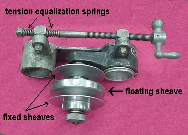

The Shopsmith has continuously variable speeds provided by a sheave assembly that operates similar to a Reeves pulley. At the time, it seemed very important to know how fast the spindle was turning, even though my edition of the Machinery's Handbook doesn't have SFM charts for turning arbutus and Gary oak. Now, I rarely glance at the tach display and just go by feel.
There is a Reeves setup for sale on used.ca Victoria that I was looking at for my bandsaw. I wonder if they're any good?
DavidR8
Scrap maker
Reeves drives were commonplace in wood lathes to give variable speed. Some like them, most hated them because they were noisy and somewhat fragile. Parts are used die cast aluminum alloy or worse and in 100% of the cases I've read about no longer available.
I contemplated buying that unit for the components. The Reeves Junior pulley included is rated for 1/4 to 1 1/2 HP use. It looks like that unit is well designed and keeps the motor shaft parallel with the drive shaft as the speed is changed.
The Shopsmith implementation is pretty cool. The motor has a fixed mount, with a belt to the "speed changer", and another belt to the machine spindle. As the speed changer is rotated around a mounting pin, a floating sheave slides on the jack shaft, increasing/decreasing the relative diameters of the pulleys for the motor and machine belts.
