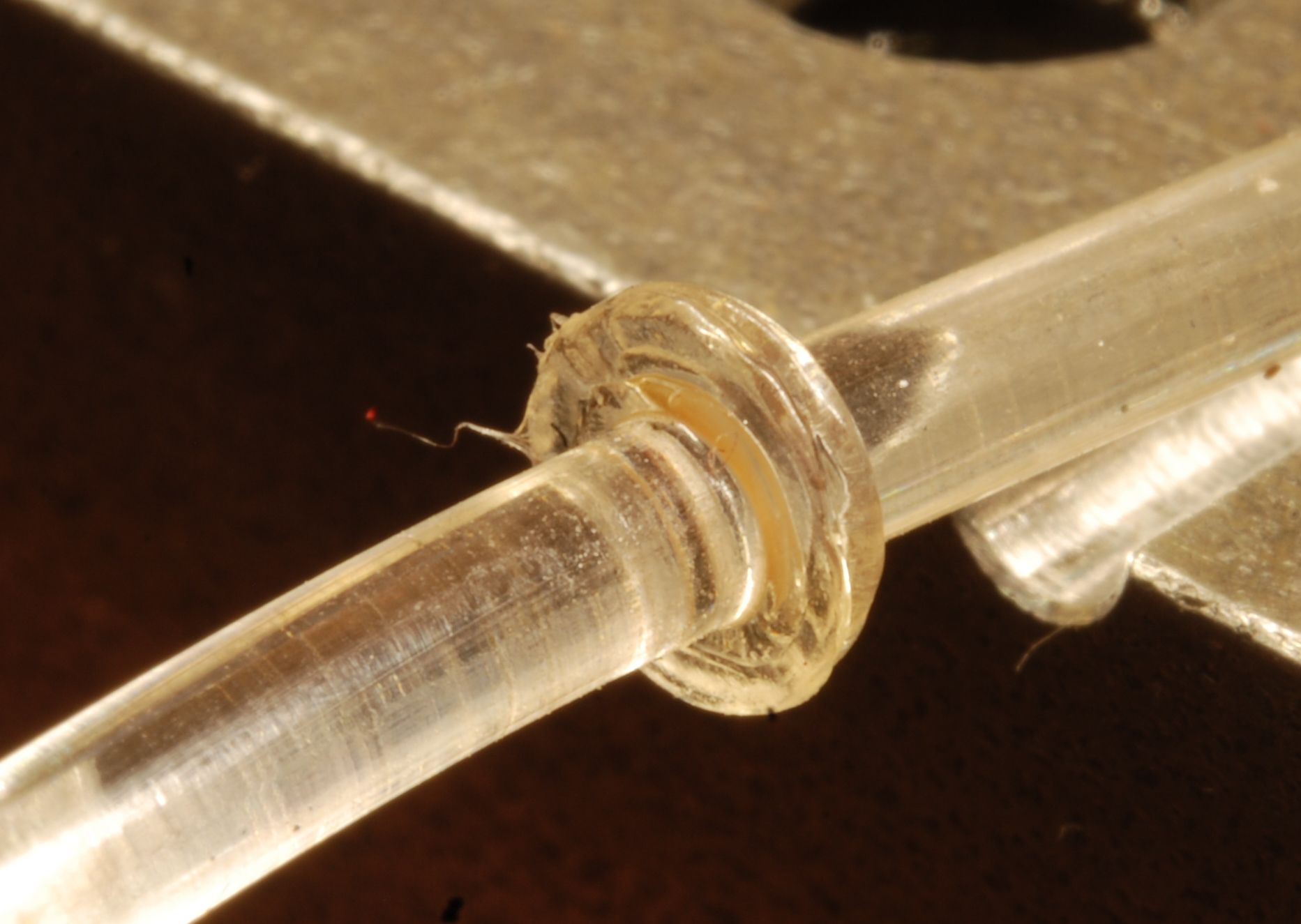

Here's a post I did on a simple device I came up with to get perfect joints with polyurethane belting. I did it as an article in Home Shop Machinist originally. The two key things for an optimal joint are prefect alignment (else you get vibration when the rough spot goes over a pulley) and a 1/2 hour cure time. The later may not seem necessary if your belts seem 'good enough', but it is how to get maximum strength and is need for very small diameter belts.
Added to top of my list for upcoming builds. The belt on my UPT is about to let go :) I'm guessing that the30 minute hold will also benefit thicker belts running over small pulleys as in my case.
thank you.
gerrit
You are welcome :) The 1/2 hour makes any joint stronger, its just the extra might not be noticeable in large sizes - i.e. the strength of a less than idea joint provides might still be good enough. The smallest I've joined is 2mm belting and if you don't let it cure it pulls apart in minutes in use.
When I made this thing I spoke with person at a US manufacturer about the finer points of working with polyurethane and that's where I told about the curing bit, which based on my experience is spot on.
Its the 2mm stuff in the photo below. That's at least a 100 year old Rivett lathe and a Hardinge pivot polisher. I'd say I was born 100 years too late, but nah, it would have been inaccessible at probably 10x the price, relatively. This is the glory age for those who like beautiful old (and highly functional) machines.
