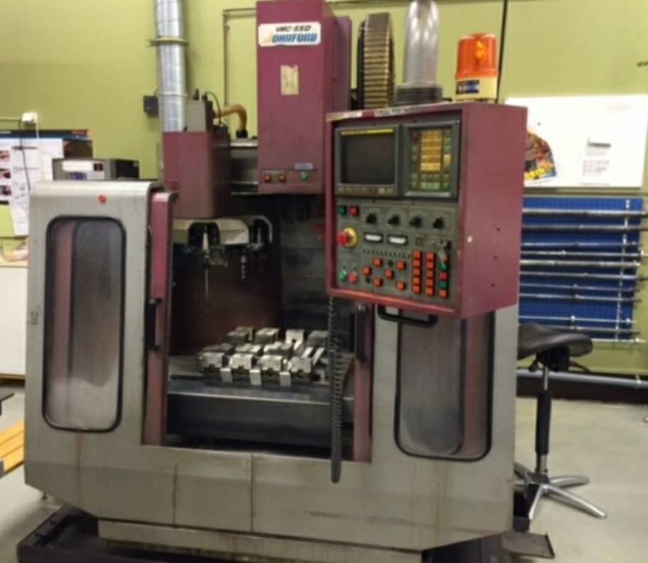

We just bought this used cnc mill and wondering what should the level (psi) of compressed air coming into this machine ?
And how do we change tool in mdi ?

Interesting Mill. What year is it? Post pics?! Have you tried googling for the manual?

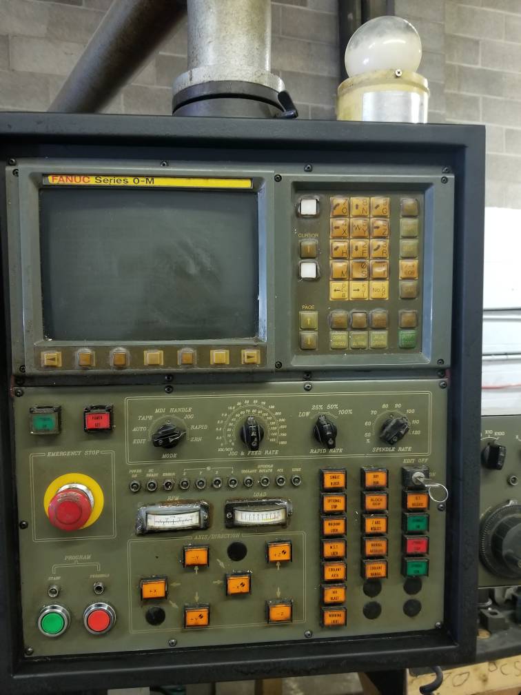

I really need some help. So, I have this johnford vmc550. I am trying to do a tool change in mdi using t1m6 but the machine is not doing anything. All the other commands in mdi are working but not tool change. I am sure there gonna be 1 stupid thing that I am not doing right but what the hell it is lol.
I have tried, end of the block as well. Tried from home position and from g30 too.

Will it change tools through some sort of manual activation? Does the electronics send a signal to the tool changer visible on a multimeter? I’m wondering if the mechanical mechanism is working and or if the electronics is sending signals telling the mechanism to move? Is the problem the software (wrong command?) the hardware (electronics not working) or a mechanical problem? Isolating the different systems may help.

Hi, thank you for the quick reply. sorry for the typo. I meant to say that it does change the took while running the program. We bought it used. I do remember that the guy we bought it from showed it but I can not remember it now.
While in mdi, does the machine has to be that the tool changing height before(g30) or the tool change can be called from any spindle position?
Can I request you to please type it here the way you would do it at the machine.

I think I understand now. The tool changer works while executing a complete program but not if you’re just standing there typing in ad-hoc commands interactively in mdi mode?
That is interesting. If you execute t1 m6 in a program will the Spindle lift to the right height from any z position or do you need to move it there with a G0 Z tool change height first?

I've got no idea what your machine requires but if it's letting you do a tool change on program I'd check the gcode and see what it's sending right before the tool change.. Janger is likely right about position and there probably is something it's telling the controller before the tool change.
Looking at some other people with the same controller you should have something like G91 G28 Z0 then t#m6 but again I'd just check any working gcode first and figure it out from there.
Alexander
It is worth saying that the tolchanger will have a program weather it is EIA format or a macro i dont know without looking. Hitting single block during the toolchange will help you analyze it. I haven't had many cnc problems in my manufacturing career but most of the problems i have had were during a tool change. There are many things happening in just a few seconds. I dont know enough to diagnose the problem on the internet
