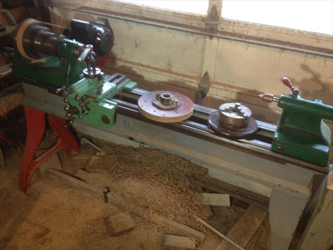

After some mistaken purchasing of tooling and ASS-u-ME-ing that my very old Fay and Scott lathe used a Mores taper in the tail stock I finally broke down and did some actual semi-careful measuring of a rather battered dead centre that fits in the tail stock which came in my box o' junk with the lathe. Based on this I'm pretty sure my lathe uses a number 6 Jarno taper. So I start looking for some equipment, like a drill chuck holder, centres, and I seem to be striking out.
Now I know I can use the lathe to make my tooling but I'm at the point of needing the machine to make the machine, i.e centre drill, work support, etc. Also, my skills are quite rusty so I'm not sure about making something as precise as a machine taper for my first series of projects. So here are my questions:
- Is a Jarno taper hopelessly obsolete? My usual (local) sources have never heard of it.
- Any ideas beyond E-Pay where I might find tooling? To start I would like a non-beat to crap centre, dead or live as well as a drill chuck holder.

Have you posted a picture of your Fay & Scott? I was curious and looked up the maker on VintageMachinery. They list quite a few "Pattern Makers" lathes but only a single metal lathe. A pattern makers lathe looks like:
AIUI, a pattern makers lathe looks like a metal lathe but has no threading capability, power feed or power cross feed. They are meant for making precise patterns out of wood for use in casting metal parts.
Is yours really a metal lathe?

I'm actually embarrassed to post pics, because of the state of the lathe and the state of the shop. Both are in "as found with some repairs and cleaning" condition.
I've thought about opening it up to an MT3 which is the size closest and there is enough meat there to do it. Honestly at this point I'm just spit balling ideas.
Well here is a video I took a few weeks back when I got it turning for the first time. Please excuse the mess. And yes it have power feed and a power feed cross slide and it will rip a finger or more off without a problem.

If you cannot ream the tailstock quill yourself, I'd be taking it to someone who can. Just ream it out to MT3 and you will be be pretty much standard with the rest of the world.
I would not invest one penny more on Jarno anything.
Not only that, but when it comes time to sell, it will be easier to sell an MT3 tailstock than a Jarno.

A combination of factors, the general consensus here as well as the fact that I finally managed to disassemble the tail stock last night, I'm going to ream the ram. Man that sounds like a euphemism... Now the only question is, do I order up a MT3 reamer or take it to my local machine shop and get them to do it.
Now for the head stock, it's either MT4.5 or a Jarno 12 based on my measurements. Guess I won't be using off the shelf collets any time soon unless I make an adapter. Project 739 on my list of things to do to improve my shop.
