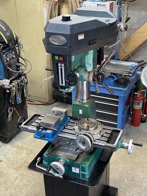

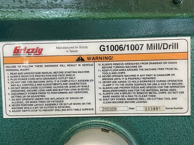

I have for sale a lightly used Grizzly G1006 that was manufactured in 2003. It has been stored for the last 14 years. This model is now called a G0705. Parts and the manual for the G1006 and the G0705 are nearly identical. Parts are readily available from Grizzly and they ship to Canada.
Here’s a link (with full specs and manual) for the G0705:
https://www.grizzly.com/products/grizzly-8-x-29-2-hp-mill-drill-with-stand/g0705

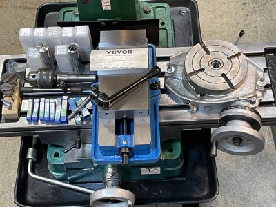

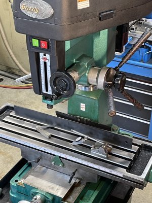

It comes with a new 5” vise, a 6.25” RT, a stand, plus other basic tooling.

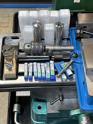

As well as the vise and RT, it includes a drill chuck and some basic tooling. (the tooling is all new and includes: 7 piece set of R8 collets; 8 piece set of end mills; and 3 fly cutters).
The G1006 is similar to a King Canada PDM-30 (or its twin the Craftex CX604) but the Grizzly is nearly 100 pounds heavier and is made in Taiwan vs the made in China PDM-30 or CX604. This style/design of machine is often referred to as a RF-30 clone.

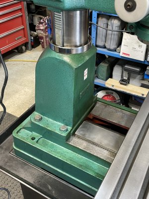

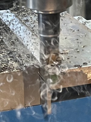

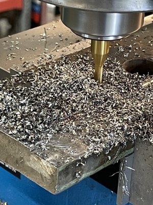

This machine is not just in good condition - it is in excellent condition. I did a test cut with it and it runs very smoothly and quiet. The column and machine are rigid and vibration free.

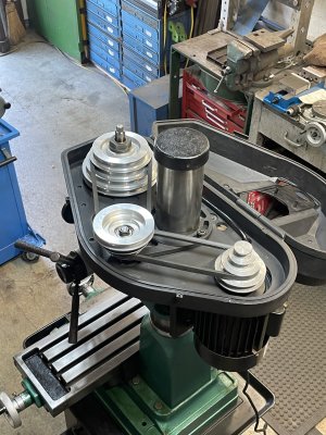

Here’s a couple more pics:
(The way cover was removed for this above pic)

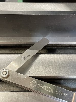

I checked the bed for flatness using a flatness gauge and an Accusize 24” straight edge. It is nearly perfect.
The 0.0012 feeler gauge will not go under the straight edge anywhere!

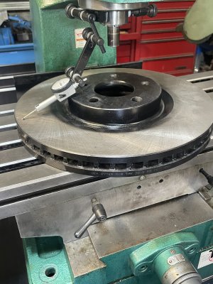

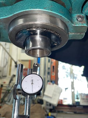

TIR on the spindle was (as close as I could measure) zero. I repeated this with two setups and used a DTI with 0.0005 resolution as well as a Mitutoyo DTI with 0.001 resolution. In both cases the needle did not move.
The column is not perfectly square to the table. It could use a 0.004 to 0.006 shim under the front right corner. I consider doing this but decided to leave this to the new owner. This shimming should be done after it is relocated and set up at its new home.
