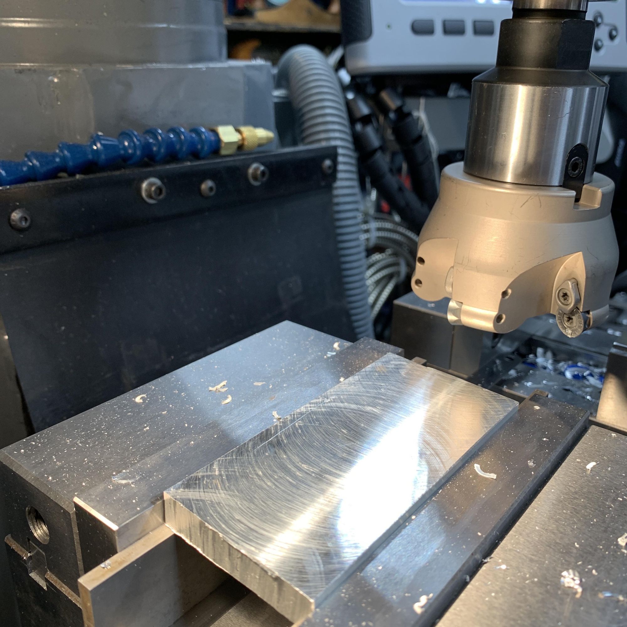

So last night I mounted my “new to me” but never used Tormach vice to my mill table. I put my Indicol ontobthe mill quill with its .0005 resolution Starrett indicator on it. Tap tap...... tap tap...... tap tap.... tap tap.... before you know it, .0002 difference over 5 inches, I come upstairs and proclaim to my wife that I am some kind of rockstar!! Slept like a baby!

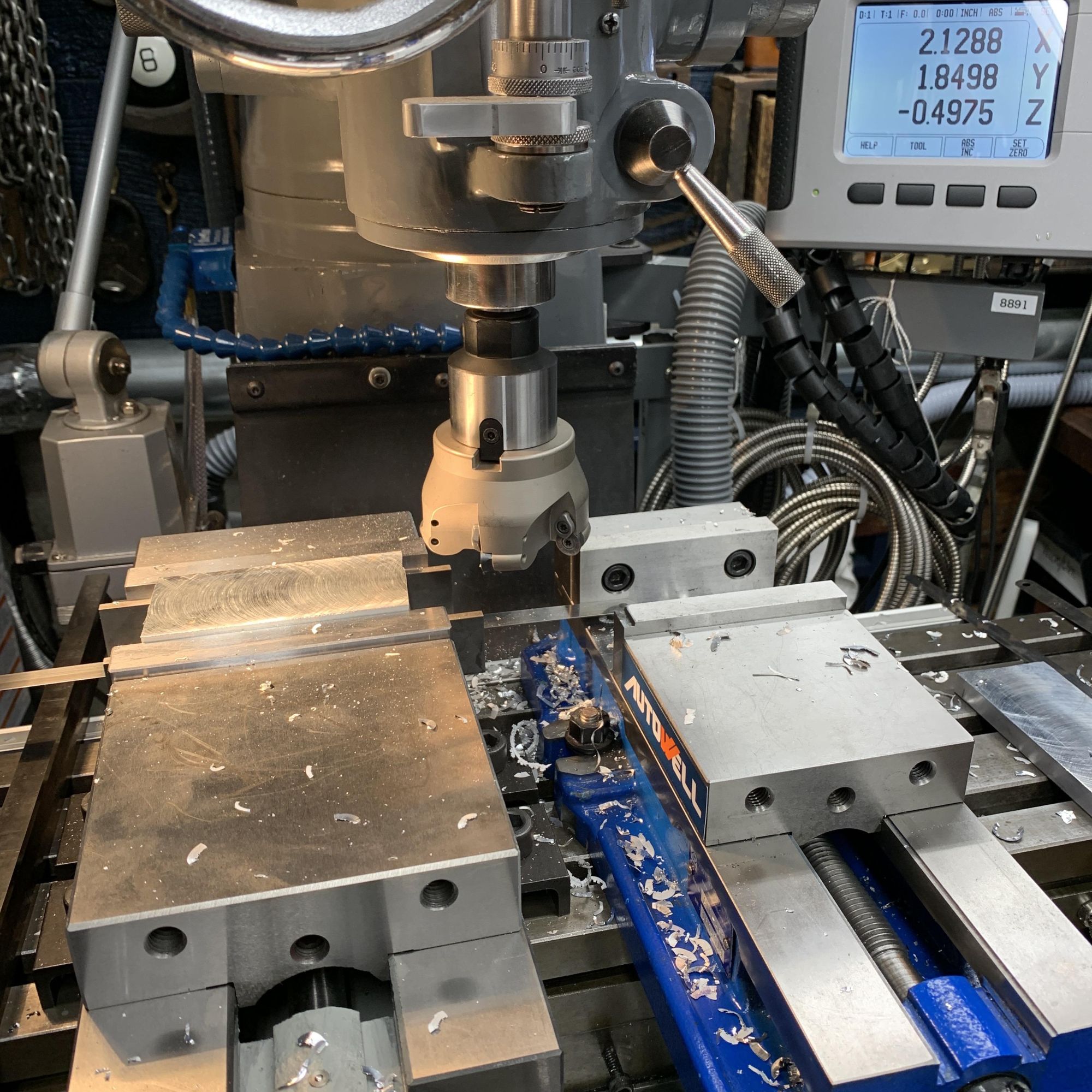

Tonight I go to the shop..... Some background, I have the Tormach 5” Vice on the mill next to the Autowell 4” Vice. I have begun a Stuart Models Victoria Steam Engine and the first operation is to make the base surfaces parallel. So the difference in height of the 2 vices is .272, no problem thinks I...... I grab a piece of aluminum from the scrap pile and put it on Starrett parallels the Tormach Vice. I use the carbide insert shell mill to mill the top surface flat, flip it over and mill the bottom parallel. I took .010 off the top and .020 off the bottom. I removed it form the vice, de-burred it and mic’d it.
Thanks for staying with me to this point.
All four corners are different thicknesses and by .005 to .009 difference how is that even possible? There are no chips - the vice is immaculate and has been cleaned with MEK (that’s some nasty sh@$). The Parallels are Starrett and mic perfectly parallel. I used a hammer (soft face dead blow) to make certain the material was seated. All I can think is that I am going to have to tram the mill head again...... and that job SUCKS!!!!

Can you show some pics of the part insitu in the vise? I can think of a few things but kind of depends on the setup & length.
One more thing, after the first skim, check to see how flat the part is, straight edge with backlighting e.g. Then after finishing that side, remove and check again for flatness. Depending on how hard you whack the piece into place, it can distort, then spring back upon release. Hence my suggestion to place it for first cut on 3 points.

So I have returned from my crusade gentlemen and I have much to share..... I’m guessing that mist if you will know already what I am about to share but think of it as you would watching a child learning to count to 100 or perhaps the ABC’s..... just smile and nod.
Rule #1. When you face something, you must de-burr it completely before flipping it over and trusting the face you just milled is flat. The aluminum faces beautifully but the burrs influenced what became the reference bottom of my piece and began the chain reaction.
Rule #2. Clamp the vice securely, but too tightly introduces bending and warping that will undo when you release the pressure.
Rule #3. Assuming that your mill head is trammed properly front to back can be a huge mistake. Check your tram regularly.
Rule #4. A digital calliper (Starrett or otherwise) is NOT a micrometer; it’ll give you a rough idea, but not a measurement (when it counts). It’s like when you are a boy and your dad/grandpa teach you how to pee in the forest. Move your feet apart a little more than your shoulders..... so you don’t drip on your shoes..... With a micrometer your accurate and deliberate. With callipers you are likely achieving the equivalent of peeing on your shoes.
According to my MIC, after adjusting .010 of “out of tram” my four corners now measure .040, .040, .041, .040. I’m not sure how I am out by .001 in the one corner but I’ll take it.

Shimming 0.010 under the front parallel over that short a distance is a lot. Something is not right. Are you saying you went back after this & re-trammed? Or you have some kind of inter-plate between table & vise? I wouldn't think about scraping until you 101% certain of perpendicular spindle & true vise.
There's lots of setups for tramming but I find using a thick parallel is quick & reliable. That way you can flip to the left-right or fore-aft direction quickly & the needle runs continuously so you can bump adjust on the fly. Start out with a coarse 0.001" reading indicator if its way out. Some people will use a digital & min/max on either side, same thing. The nod direction is the tricky one because the pivot point is aft of the measurement points, so its a bit of iteration.
Once the spindle is bang on relative to the table, now go back & do the same thing sweeping your vise base rail. If you have accurate parallels you can lightly clamp them so they extend proud where you an indicate across & that will show any relative twist of the vise.

That is a lot of stick-out on that face mill.
