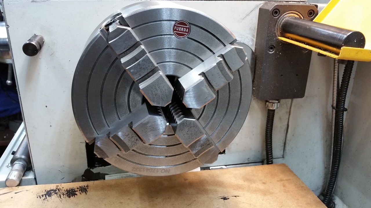

Nice 4 jaw Bison chuck. I am in the process of re-grinding all of my Chinese 4 jaw chucks as they were all different degree of crap. I am actually doing it on a milling machine. I got angry after I had to re-do a project b/c a 4 jaw was super inaccurate. A good 4 jaw is more important then a good 3 jaw - you expect 3 jaw to be "inaccurate" but expect 4 jaw to be bang on.

BTW I just ground my last 4 jaw - I checked my 4 jaw 10" before it had a runout at 1ft mark of around +- 5 thou and now after I ground it it has +-1 thou at 1ft. Not idea but my Chinese chucks all at least doubled in value. They are now "premium" - made in China finished in Canada.
Do you have a procedure or write up of this process?

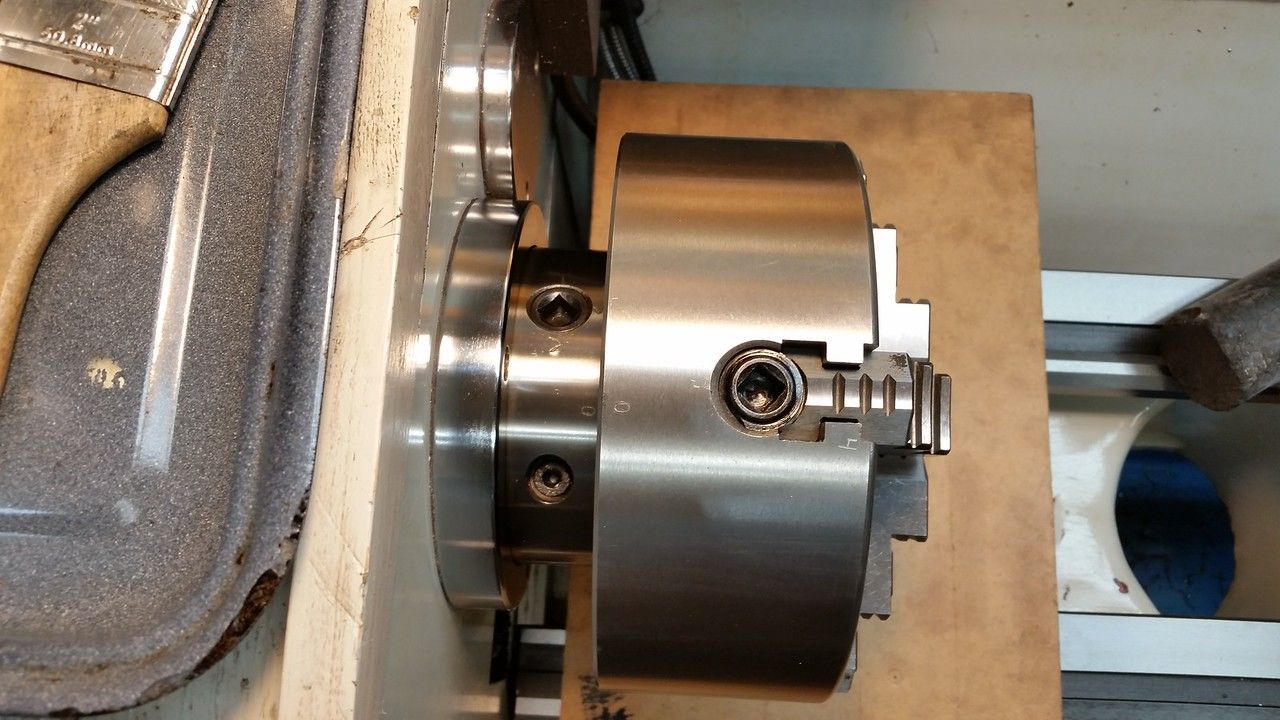

The 2 chucks and faceplate that came with my GH1440W lathe from Modern already had index marks on them as does the spindle. When I bought the 8" 3 jaw Atlas chuck I had to machine a backplate for it and after the chuck was mounted I measured to determine which of the 3 orientation positions yeilded the least amount of runout and stamped the chuck and backplate to match the others.
I measured the runout of my 4 jaw and it is very true from the factory. I took a short video clip showing the measurement.
This is the Atlas 8" 3 jaw.
This is the 6 inch 3 jaw that came with the lathe, as you can see both 3 jaws have about .002" runout and the jaw alignment is nearly perfect.
