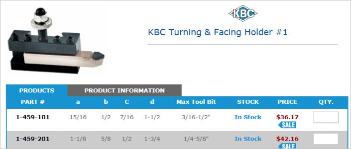

Shars looks like the ones I got from KBC a while back. Good price but $FX & how you land them might gobble up the savings. They don't even attempt to rebrand anymore, proudly says made in China.
http://www.shars.com/turning-and-facing-holder-1-type-201-xl
I purchased mine from KBC in the past because if you buy a few the weight adds up & I like $8.95 to my door delivered within days. They claim to be interchangeable with Aloris/Dorian which I have heard people claim is true. I have the matching Chinese tool post (piston style) but what I'm saying is dimensionally they seem to be pretty good & consistent. I had to tune up one but it was not the dovetail surface. it was incomplete chamfering on the edge. At least with KBC you stand a chance of exchange/return & reasonable return shipping cost. That might be more problematic with some of the other vendors.

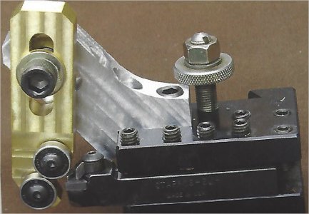

Cant recall where I found this pic. I had a more complicated scratch built idea of this concept, but as you can see he basically modified a stock one. Might be a better way to snug up & secure the bearings into position against the part than the cross bolt, but anyway, interesting idea that maybe mitigates installing the travelling steady for skinny fiddly bits.
