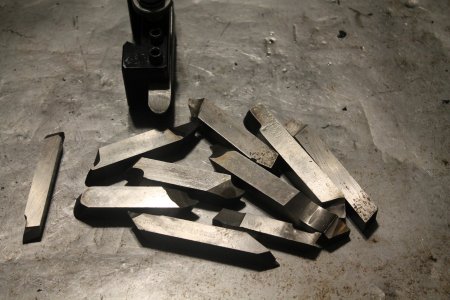

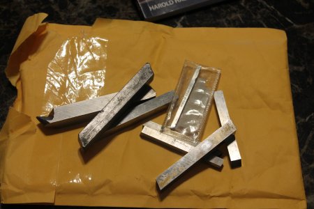

And then it was the hour trip to perth to Cardon tools well worth the trip, only down $150 but will be making return trips as after an hour and half of looking was enough for me that day, nice family run business still write up bills by hand, had the kids putting away small stuff a nice afternoon thanks to @Rauce for the reminder, They got me a box and I just walked around and emptied my hands everytime I went by, asked about d1-3 stuff but it sounds like it goes fast so I will have to call and check when I remember.
Anyways they had a hss bin so I used my hoarder tendancies to up my collection. and some had some nice previously ground ones that were interesting and ready for use.
