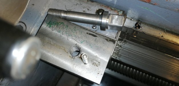

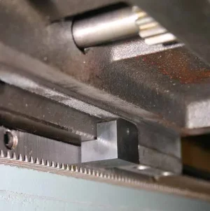

Here it is assembled in. But it does not tighten as I either have to add something to the "Green" area or I have to mill down a bit the area opposite to green.
So what should I do? Currently I think of adding a brass shim about 1mm thick to the green area.
What should I do? Other than this it fits perfectly. Original part was missing.

If that's also the carriage lock then it seems to me that it should be loose till tightened?
Mill the other side of what? I'm not following.
Tom can either make the part that bears against the bottom of the ways thicker with a shim or mill away some of the area that bears against the bottom of the carriage so that it doesn't bottom out before it clamps down on the underside of the way.

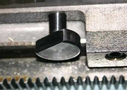

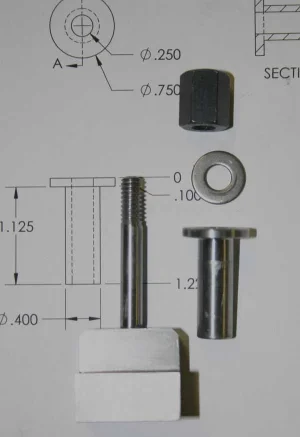

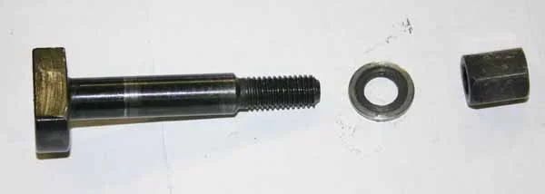

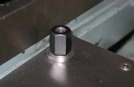

I wasn't quite sure if your issue was the same as mine, disregard if not. My 14x40 had a very vague feeling saddle lock. Very little contact area & it was acting at a distance from the saddle underside. It would spin on its axle, loose orientation or stick the saddle movement depending on the gravity of the moon. Just plain goofy.

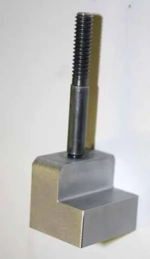

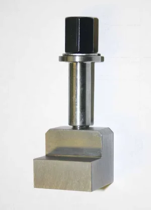

I made this one. A profiled foot

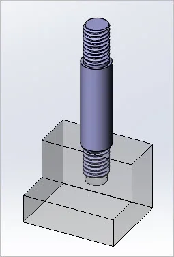

On my three lathes, the carriage lock block looks something like this:
For best clamping force, one needs a pivot so the block can clamp onto the underside of the way. This is a very powerful set-up - I usually only “snug” the lock bolt.

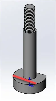

My Lathe is similar to @RobinHood but sideways.
Looking at it from the tailstock it looks like this:
My drawing isn't great, the left side is quite a bit wider than as drawn. And the entire block extends along the way about 3 or 4 inches.

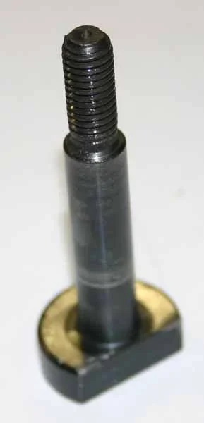

My lathe is Czech made so they had enough foresight to add a pin - seen on picture that keeps things properly oriented.
