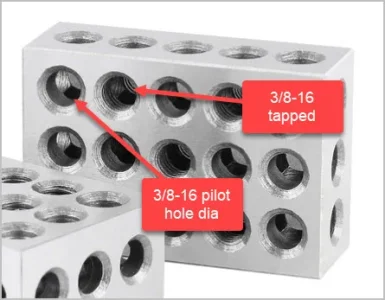

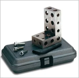

Maybe this sketch will help. The pseudo clones have an array of alternating threaded hole & through hole. But their through hole diameter is smaller than the shank dimeter of the thread. My guess is they drilled all the holes in the block with the same pilot drill size (example 5/16) then tapped the alternating holes (example 3/8-16). So how do you pass a 0.375" OD fastener through a 0.3125" hole in order to mate the blocks together? Yes you can put a smaller diameter fastener through the small pilot hole, but its not going engage the thread so what's the point. The other picture shows what I think are the original concept - the non threaded hole is a clearance hole size.
Yes I have seen similar offshore blocks based on metric too. Some are 123 (as in inch) with metric threads. Some are metric block dimensions with metric threads. Whether its imperial or metric isn't really this particular issue. The question is are they (thread + undersize) vs (thread + clearance).
