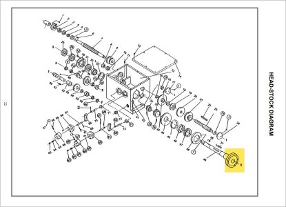

How do I get the original backplate off of the lathe??? In the last picture, you can see the piece I am referring to. In the third picture, I am showing the flange that is loose because I removed the three allen bolts that are holding it on.
I'm not familiar with the lathe but looked up the manual here
Just to clarify, when you say 'original backplate' you mean the highlighted plate on part 49, the spindle, which appears to be fully integrated into the spindle shaft itself?
