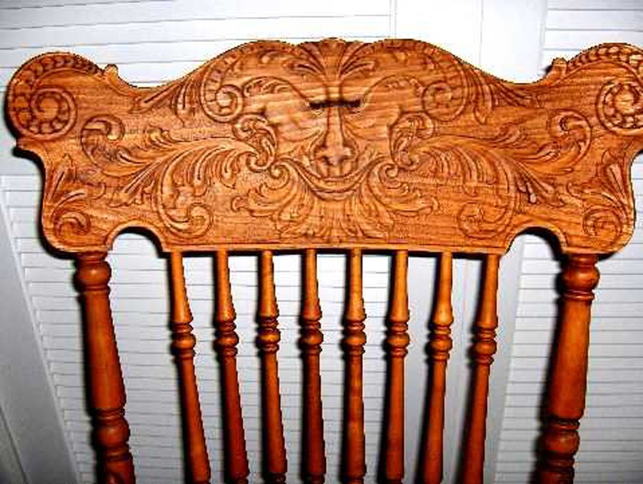

I think it is more likely that the features that appear to be 'carved' on the knobs were actually made by a steel die and pressure. Same as "press back" chairs. For info, see:
Yeah, I'd go with this! Factor in for some steam or simply heat in the equation, and you can make wood do all sorts of wonderful things!
Same method was commonly used for clock cases in mass production. No money in it, if you need an expensive Ornamental Turning Lathe, plus a LOT of factory time, to make something as cheap and simple as a knob for a radio!
I think you nailed it. This makes a lot more sense to me. The base circumference of the carved splines seems to be a little bit lower than the area outboard of this circumference. Learning something everyday.
